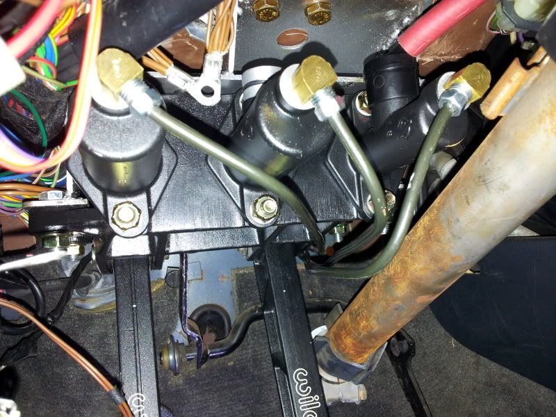

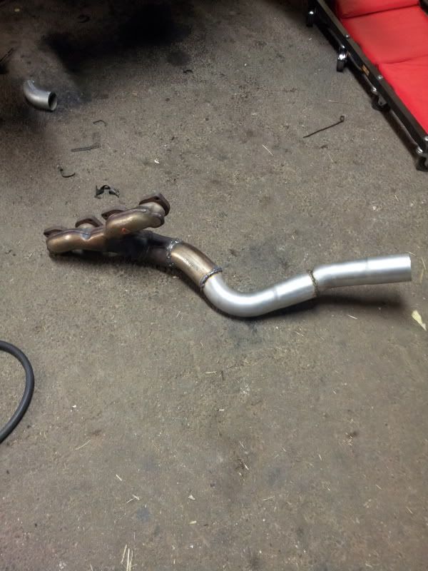

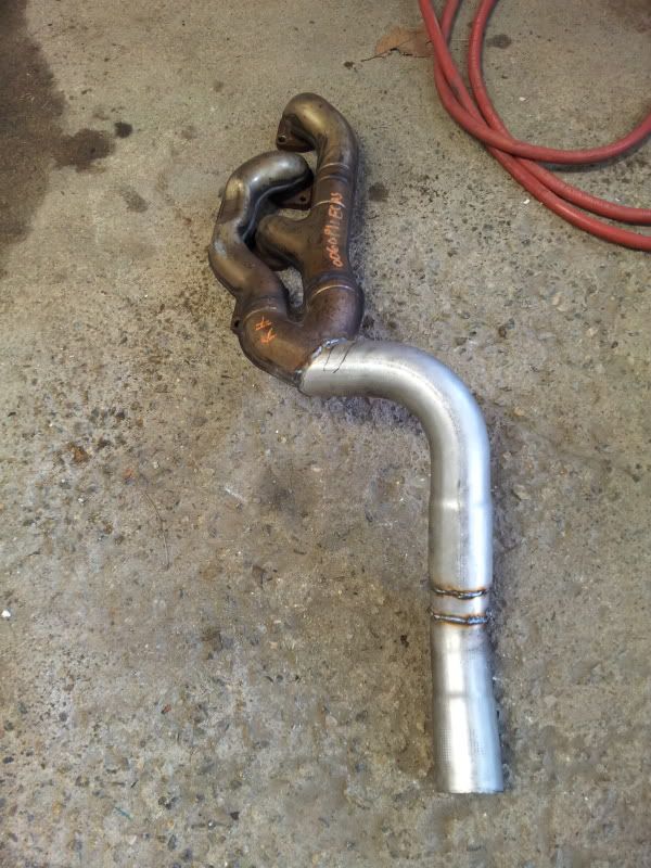

                    I made my right side header today and my pedal mount.

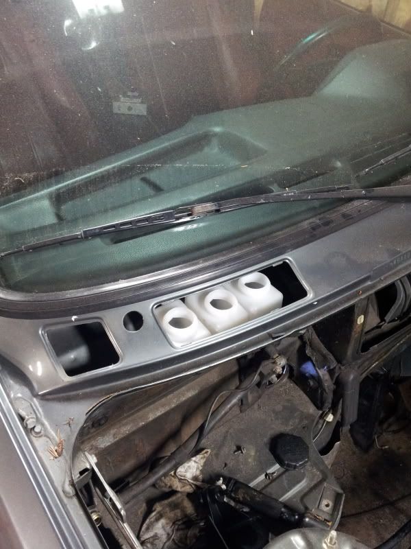

                    I am thinking of putting my reservoirs up here with the cap sticking through the dash. I am going to see if it looks clean or if I will have to make a dead panel on top of the caps. I am pretty tight on space for these and this seemed like a descent option.
                    ___________________
                    Mark

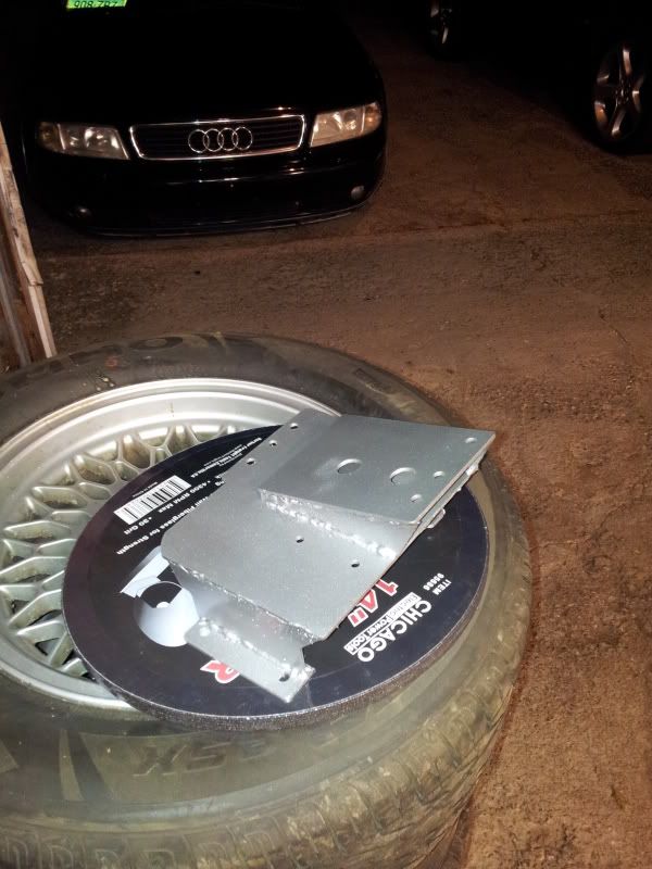

                      Did you purchase the plans for the bracket hardware or bought it somewhere?
                      • mark///m3
                        • Oct 2007
                        • 287
                        I bought a kit and welded it myself. I will look up the sellers info for anybody interested.
                        ___________________
                        Mark

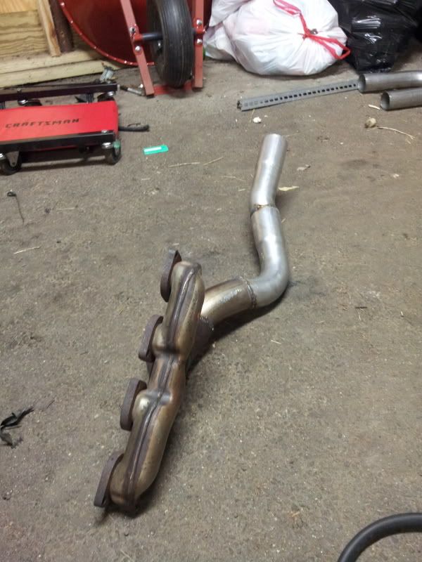

                          I was away this weekend so not too much progress but I did manage to make the driver's downpipe last night.
                          ___________________
                          Mark

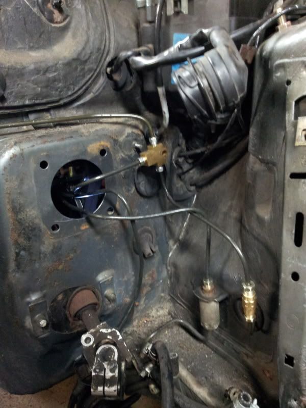

                            I had some time to make my brake lines and after staring at my car for a solid hour (part of every project it seems,) I found a nice spot to put my reservoirs without destroying anything.
                            The lines look scrambled in this picture but they come together nicely and will go through a hole in the plate i will be welding on and then sealing up.
                            And my reservoir mounting location. I would like to have only two but does anybody know if it safe to mount a y fitting in the lines and have it feed the front and rear masters?
                            ___________________
                            Mark
                            • dirty30
                              • 3013
                              DO NOT share a resevoir for front and rear together. I've seen it done but in a worst case scenario if you lose a line in the front or rear circuit you can still rely on the other one to get you slowed down/ stopped. I mounted my resevoirs on a bracket I welded to the blower motor panel. I routed the lines through the large hole where the booster once was. As long as you have the reservoirs above the level of the master cylinders you're fine. I even though of fabricating a bracket for the drivers strut tower to mount them on.
