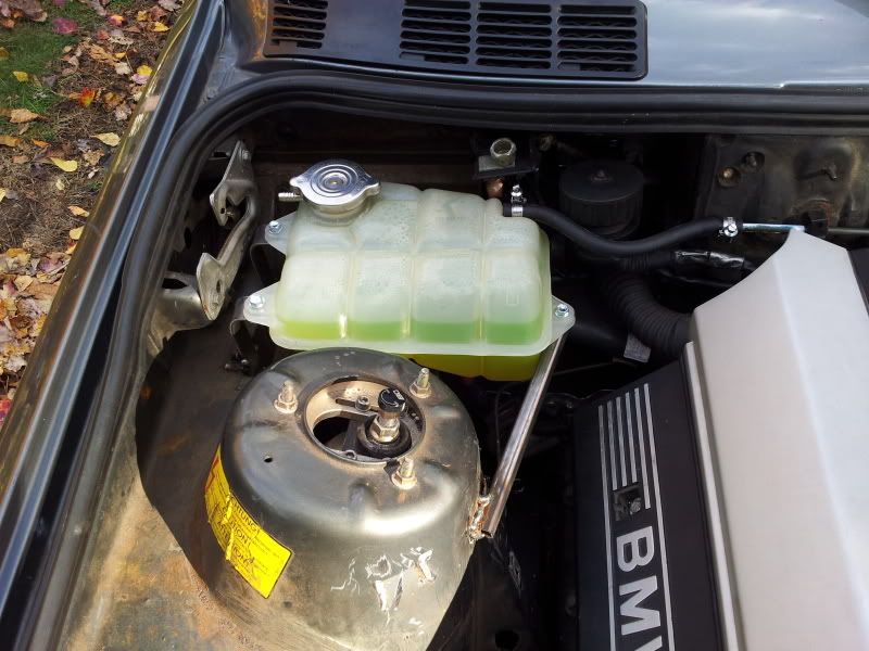

    For the reservoir, consider a 1989 and newer E30 reservoir - it bolts in the LF fender-well area, where you have lots of room with the manual brake setup.

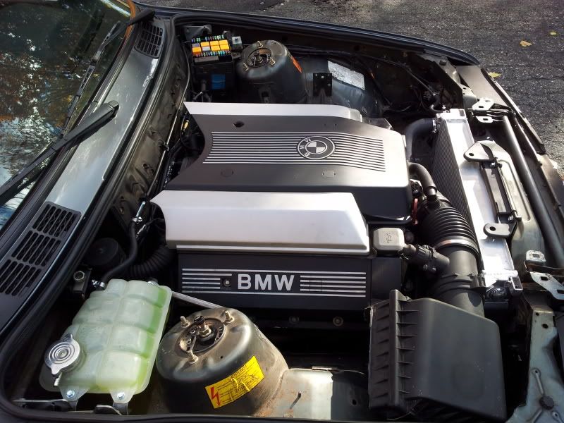

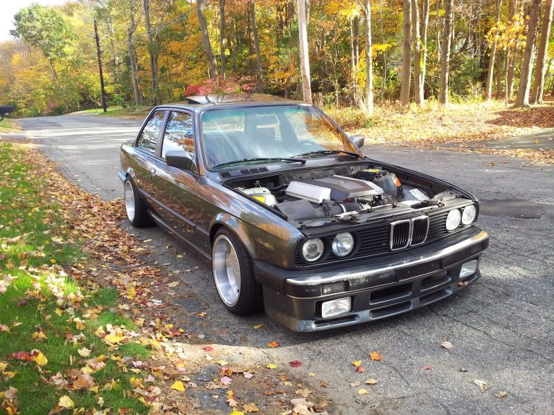

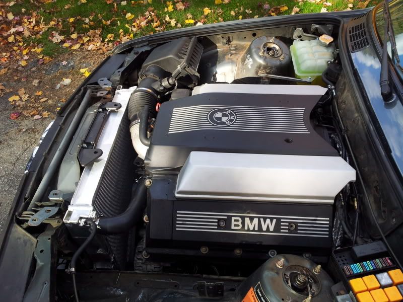

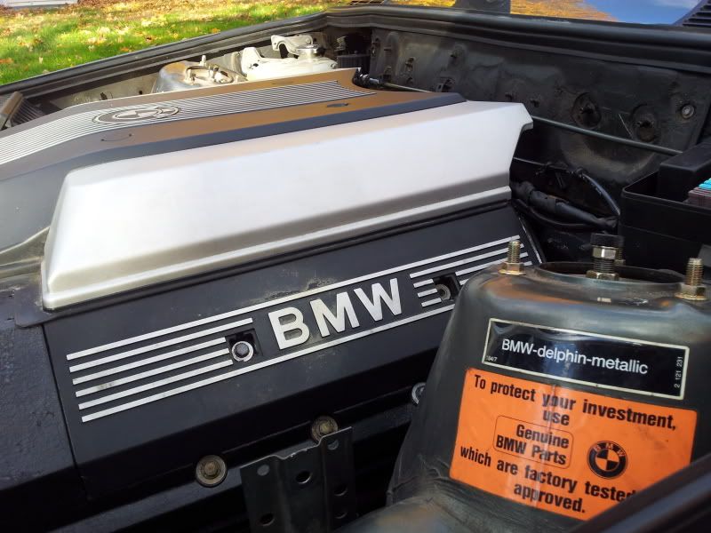

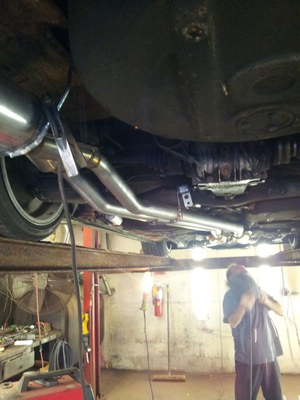

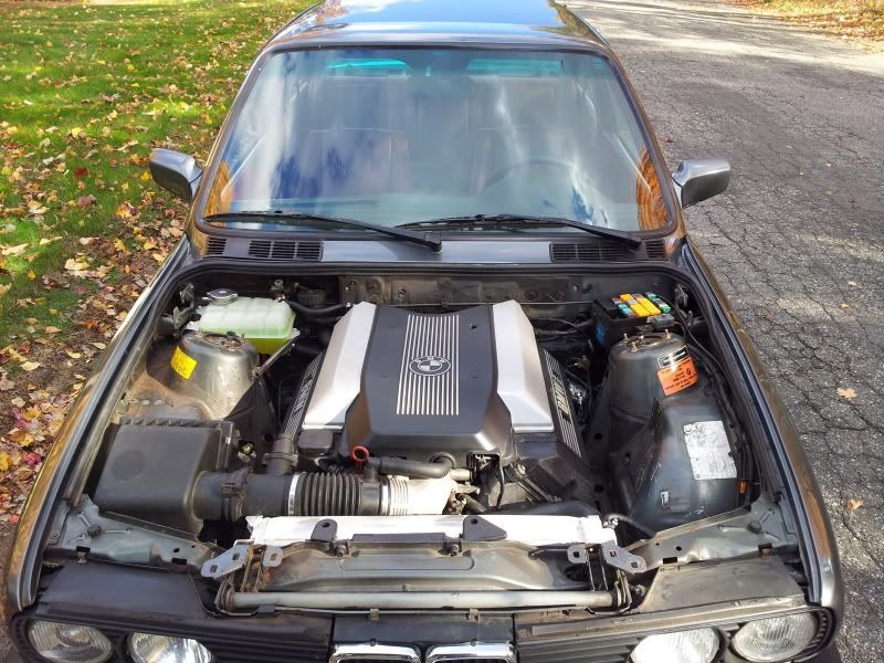

          I ended up using a Mercedes reservoir from an old s class. The car runs great, I have some small things to work out still but its driveable so that's a great feeling.
          Here are some pictures.

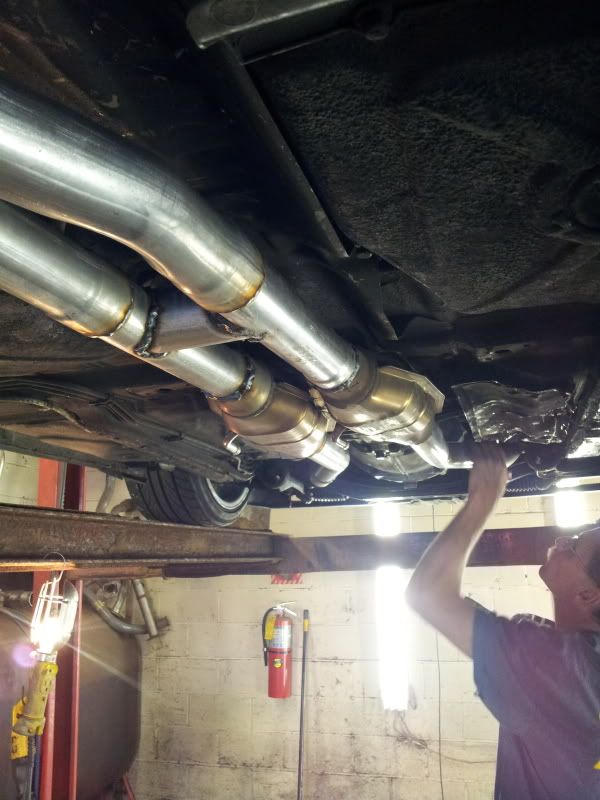

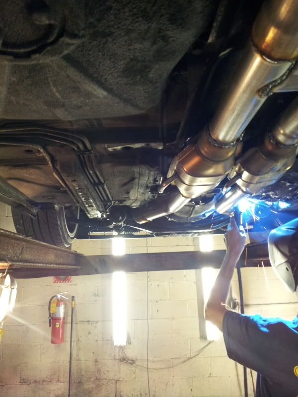

          I wasn't happy with the height my exhaust was done at so I had some nicer bends made and welded in. It sounds a lot betternow too!
