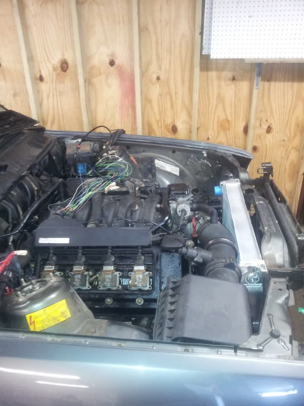

    I ended up using a Mercedes reservoir from an old s class. The car runs great, I have some small things to work out still but its driveable so that's a great feeling.
    Here are some pictures.
    I wasn't happy with the height my exhaust was done at so I had some nicer bends made and welded in. It sounds a lot betternow too!

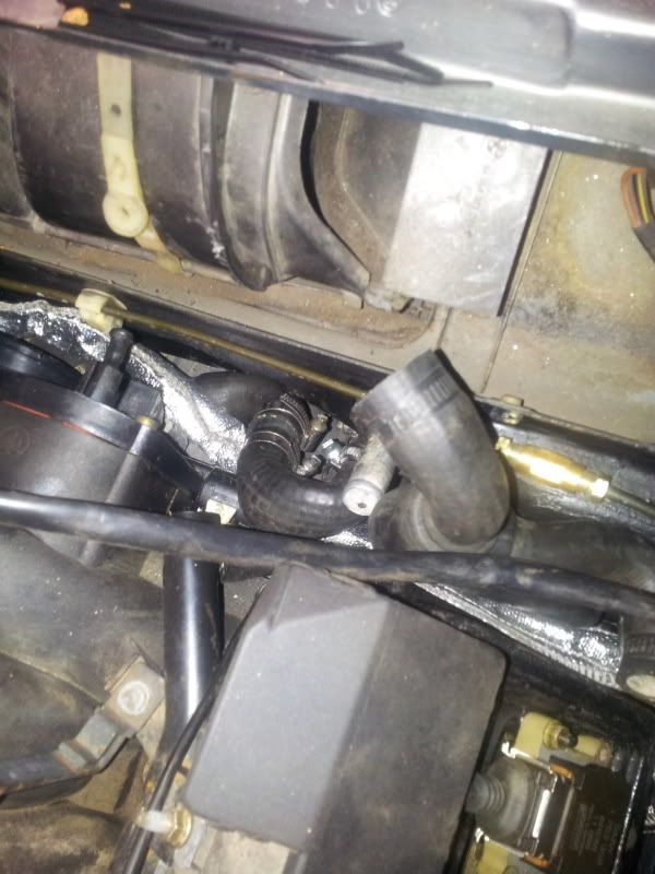

    I am still trying to figure out a solution to my reservoir and heater core lines. I am toying with the idea of a sealed system and put a fill in the upper radiator hose. I am not a huge fan of the idea though. The lower hose in the picture has a little flat spot but still has almost all its flow. The picture is deceiving...
    You need to TIG it in order to make it work properly..

    I got the radiator support installed again and decided to use the factory e34 condenser fan as my cooling fan.

  • mark///m3
    replied
    It runs!
    i still have to figure out the coolant reservoir mounting. it seems the hood is going to hit the cap so i need to do a test fit then reinstall/weld my radiator support on.

  • mark///m3
    replied

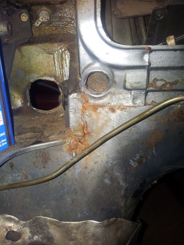

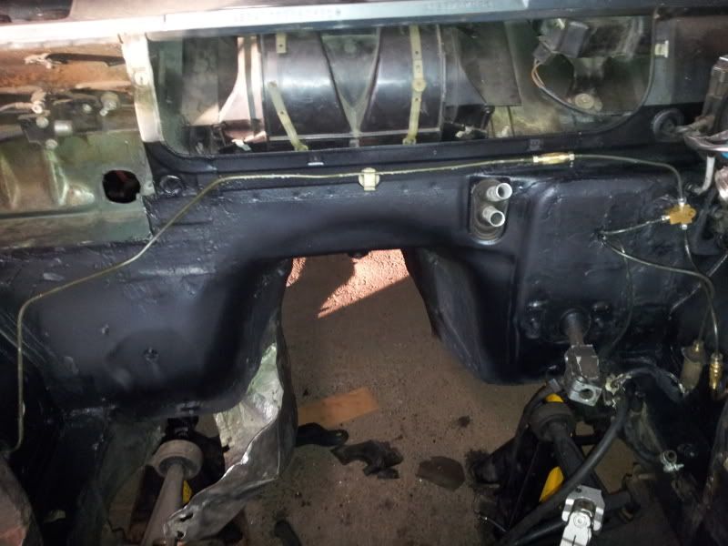

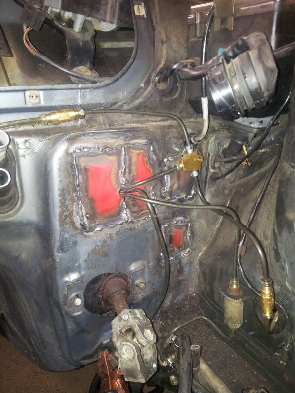

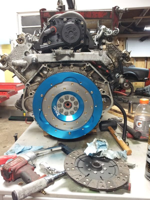

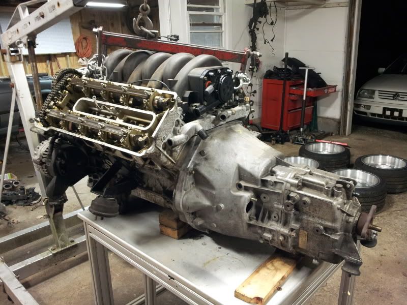

    I welded up the booster hole and the clutch master feed and return holes. I finished those up and noticed a nice little rot hole starting on the corner of the battery tray so I cut it out and I welded a plate up sealed them up primered and rattle caned the firewall with some bedliner I had laying around. I figured nobody is going to see it so black was fine. The bay will be able to get sprayed at a later date body color. I also changed the intake gaskets, back oil breather plate and scraped some carbon off the intake ports. I bolted up my flywheel and clutch as well as the tranny tonight.
    I figured I should take a picture of the flywheel since it cost more then my engine.
