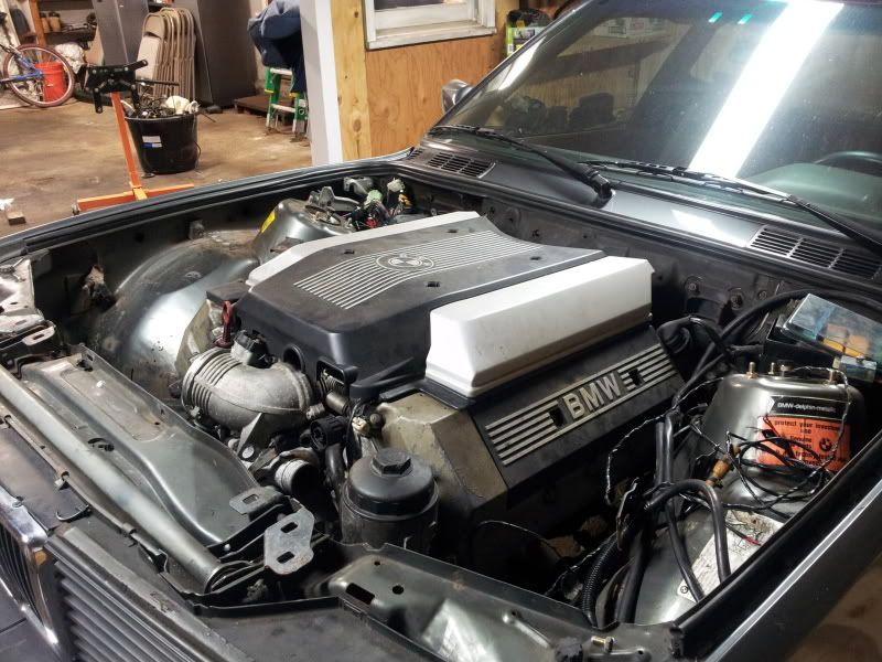

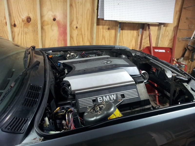

    Just wanted to give myself some inspiration....

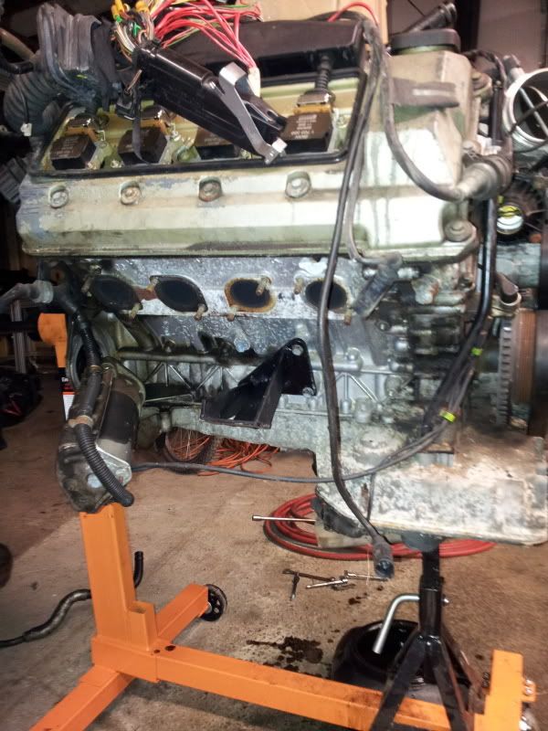

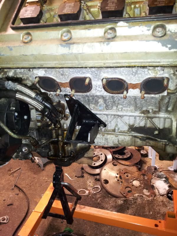

    I got my mounts and spacers from Garey today, they look great and I had them in a weeks time after payment!
    I bolted them up and am now figuring out what to do about my oil filter mounting.
    I am either going to adapt the old mount/oil passage to fit over the new arm or explore the idea of the remote mount plate from a m62. Any input on this one is appreciated.

    I hope to drop the engine in place by the end of the week just for some inspiration.
