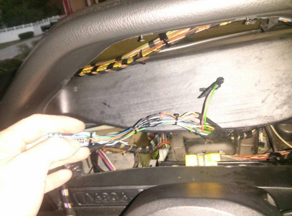

Need what from Dakota Electronic ?So, finally had time and the needed info to get back to project Jack-N-Coke
So today i installed the Garagetastic tach mod for the V8 swap.
Decided to mount this on the "blue c1" plug off the back of the cluster. Keeping in the cab, away from harm.
So if your interested in doing the same I'll post up the info below.
Blue C1 connecter
Soild brown = Negative/Ground
Grn/yellow = 12v/Positive
Pin #7 solid black splice this in dme to tach
Yellow to tach , white to dme.
Remember Garagetastic's mod requires a 4cyl tach plug. This mod will not work with the 6cyl plug
You'll need a Dakota Elc. Setup for the 6cyl.
[ATTACH]77077[/ATTACH]
[ATTACH]77078[/ATTACH]
[ATTACH]77079[/ATTACH]
[ATTACH]77080[/ATTACH]
After shrink rapping it and zip tie-ing it it the wire harness it is now protected and hidden
