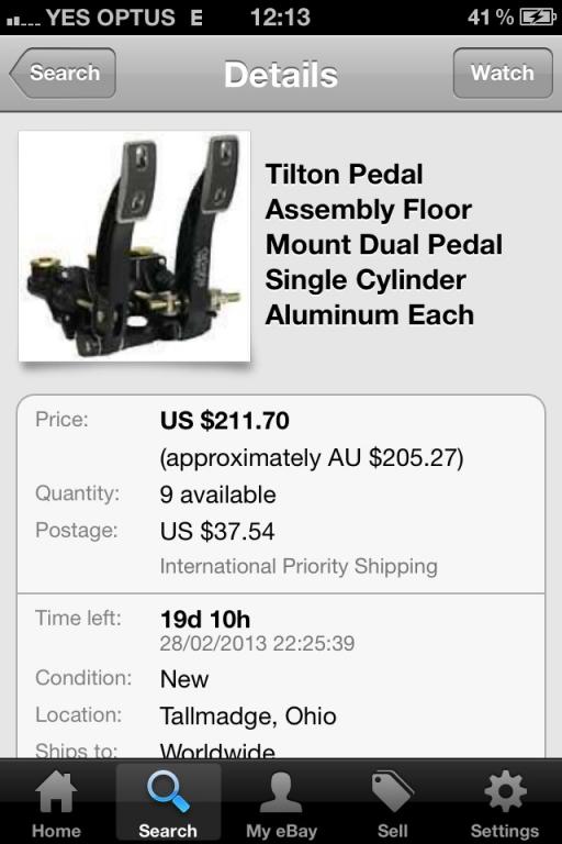

                Update: this has been purchased saves me bullshitting around with booster setups. RHD complictaes that 10 fold. Click image for larger version
