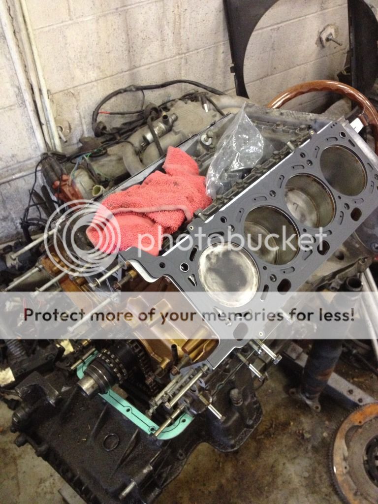

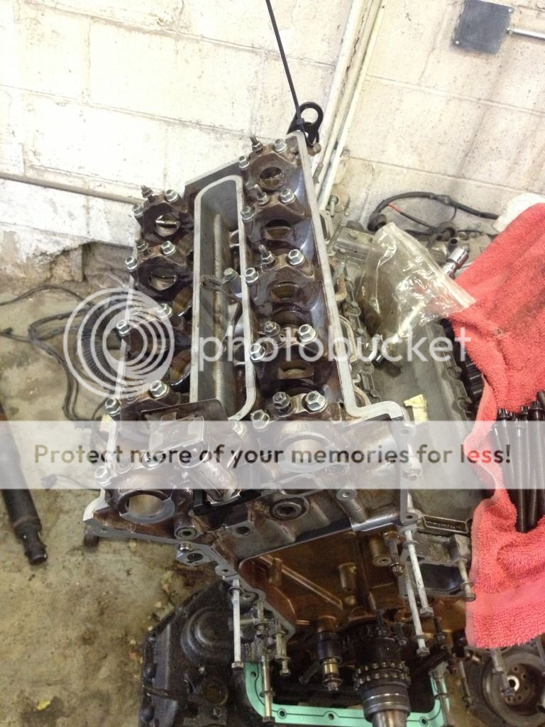

So I was a little busy today, got off work early due to weather and thought I go ahead an accomplish this today... And then i remember why I don't like rebuilding engines, Head torque blows!!!
I like how it's looking so far...
Now what to do for the gasket that's in between the upper timing covers, probably going to cut up some 4.0 headgaskets or something. Idk I will think of somethingComment

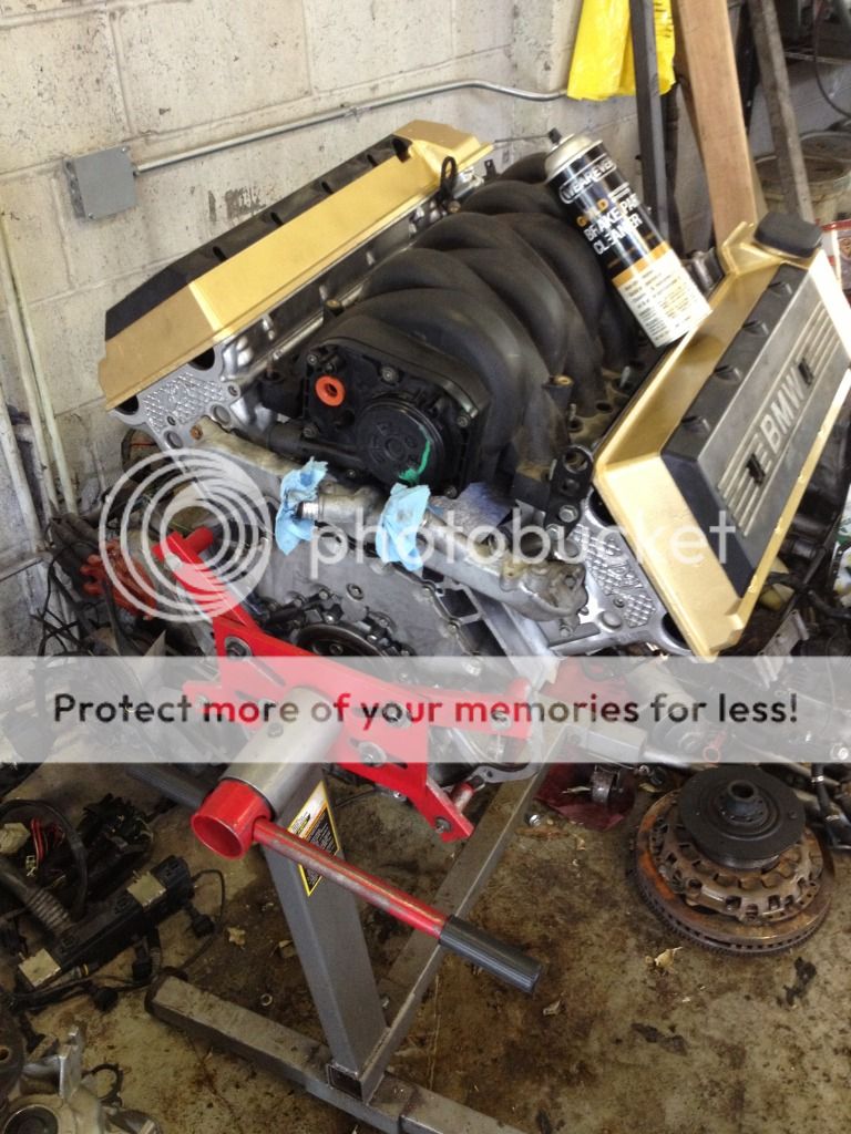

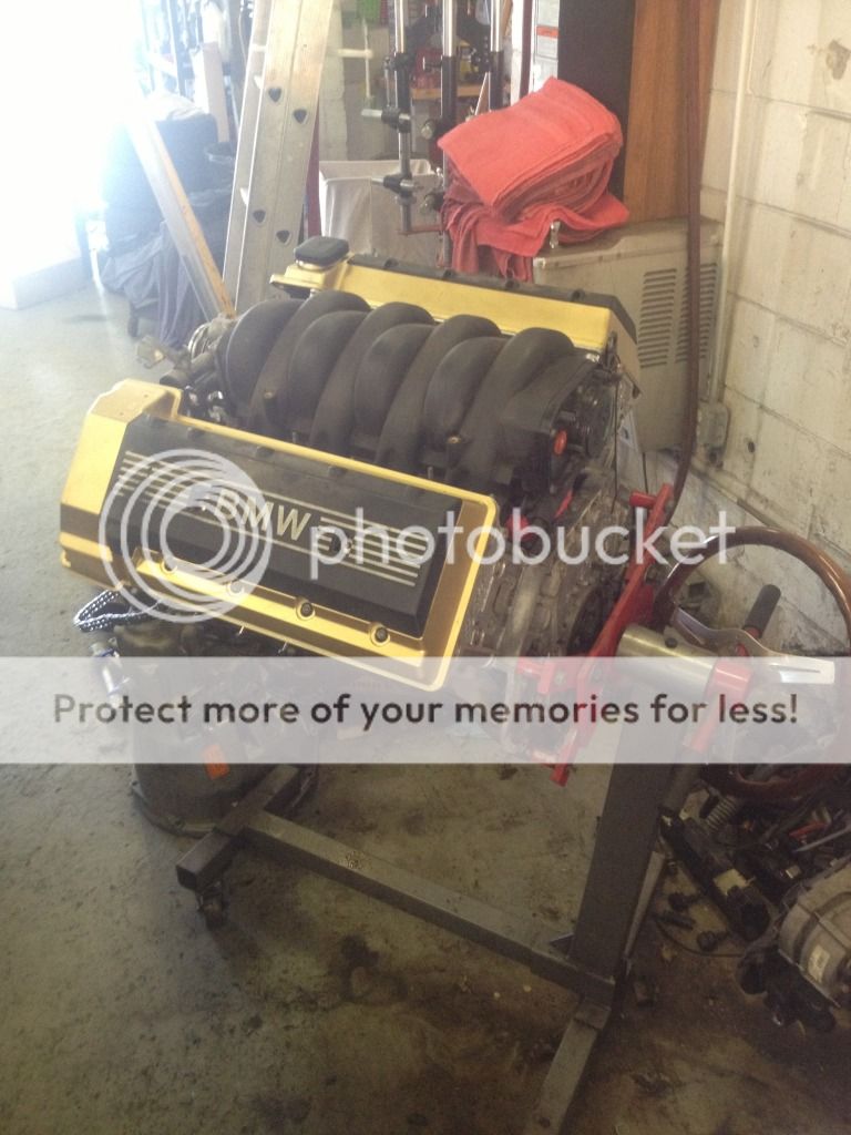

Did more work today on the motor, replaced the coolant U-shaped gasket on the back of the motor
Put on Garagistic motor mount arms

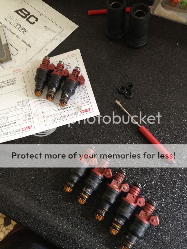

Left my injectors in parts cleaner for about 2weeks and they cleaned up great, removed all the O-rings n will be buying new ones soon.
Still waiting on tensioners to come in so that I can put the motor in timing and finally take it off the stand and do the rear main seal and also put the clutch n tranny on. Which I bye ordered the wrong sized tranny seals :-/ so that will have to wait till next week along with other things along with the dreadful purchase of the lifters.Last edited by driftingminor913; 05-31-2013, 01:21 PM.Comment
