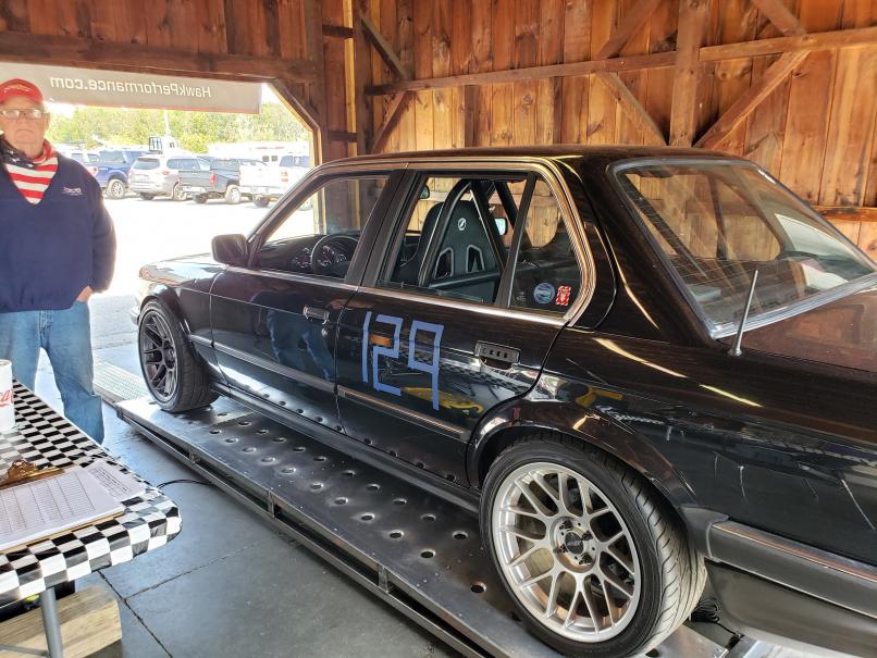

                            Took the e30 to VIR this past weekend for NCe30 Oktoberfest. Did some great skidpad run on a autox they setup and also got a few hot laps on the main course. Car and engine did great.

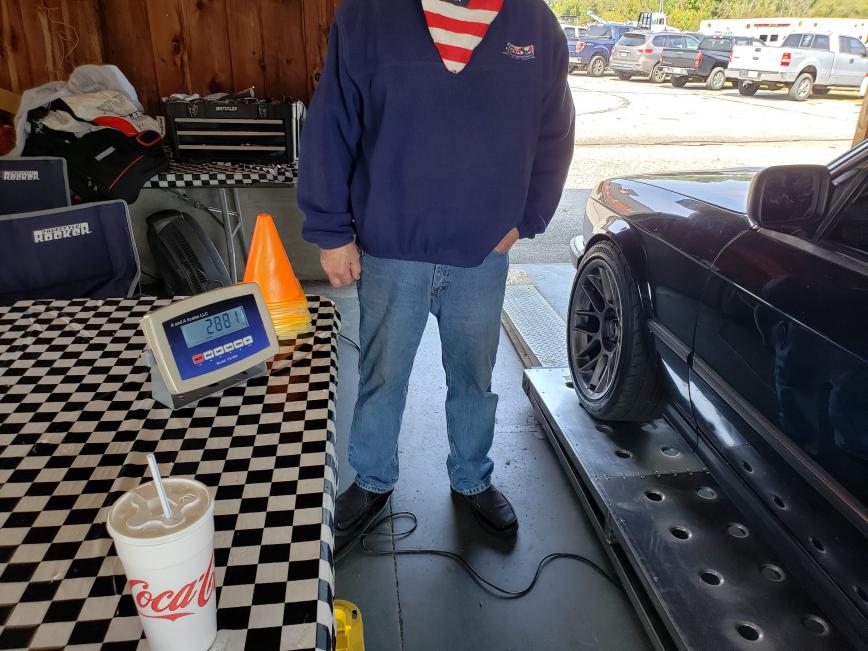

                            Got the car weighed as well. 3/4 tank of gas, full interior minus rear seat back, lukebox 10" and amp plus rollbar. No driver
                            2881 pounds, I'm happy with that but would like to get it down in the 2700s by next year. I will be upgrading to fixed back seats and harness for next year.
