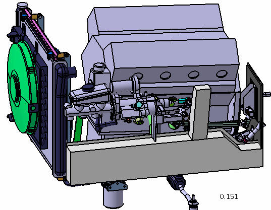

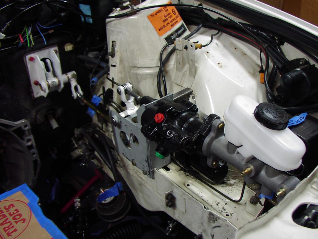

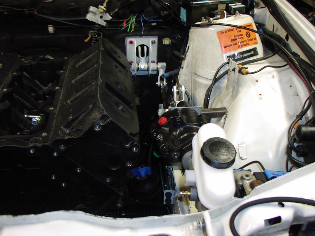

                  re: HydroBoost for E30 ---
                  Try this one:

                    What would a setup like that run? very clean looking...
