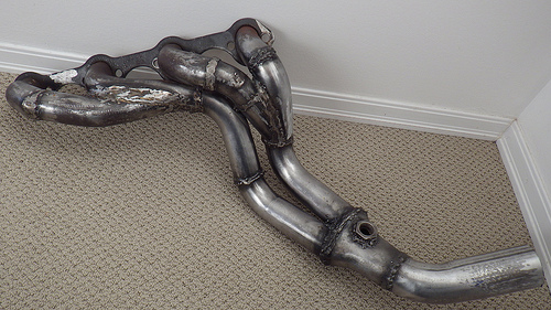

                              On a more relevant note, just finished making my Y pipe... yep, finally making a real exhaust. Fitment is a whore btw. Pics of where I stopped tonight:
                              Hopefully the collector I made isn't too shit/restrictive and won't hurt me too much. Thanks to eurotrash for giving me the idea for this pipe... pretty much copied his (to a degree. I made adjustments for what I thought was more efficient and would fit my car better)

                                #60
                                That y-pipe looks great! I have been modifying a header to fit between the block and the steering shaft, but have never welded before this.
                                http://www.flickr.com/photos/111877347@N03/11825500386/
