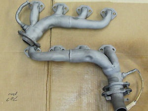

    Are you modifying your steering shaft or shimming your engine mounts at all to make this header fit ?
    Has anyone tried using a 91-93 thunderbird/cougar 5.0 header
      sorry bro, but I don't see that working period. at least not easily anyway. here's a few shots of my engine bay:
      As you can see it's pretty tight in there. Considering what you've got going on, I'd get two passenger headers (stock) sending the drivers' side forwards and the passenger back. This is the only way I can see cats fitting in there (close to the manifold like you were asking about)
          I did take some measurements and concluded that manifold wouldn't work, but didn't have one handy to confirm. I am using an E46 steering shaft because it's smaller and cheap used.
