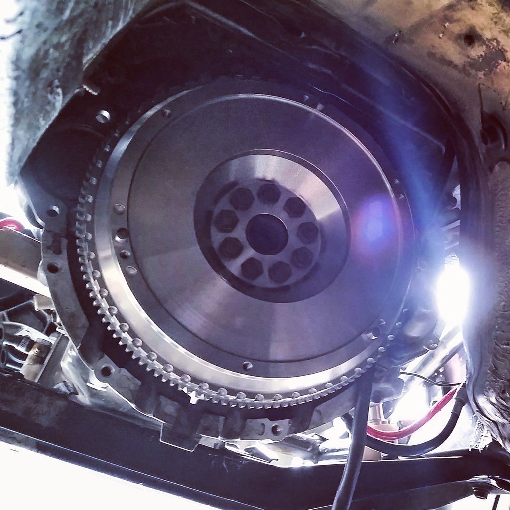

      heres a picure of the TTV racing flywheel installed, great solution to this problem, it is steel but is still way lighter than the dual mass
      i havent gotten a e36 clutch yet but soon
                Any updates on the success of this option?
                And here's a dumb question, for people with front mount crank wheels (M60s or adapted M62s if that is possible with the addition of the sensor to the front cover), why can't the e36 M3 flywheel be used? I saw that offered in another thread as an option a while ago. If it would work, it makes the flywheel cheaper and lighter.

                  I am also running the ttv flywheel to s50 clutch. I use a s50b32 pressure plate with a sprung 240mm disc (S38b38 disc). Beware, this disc is too thick!! I had to space the pp 3mm from the flywheel to get it to work.
                  Apparantly the S50 disc is thinner. Anyway, it does work great now. No slip, and engagement is very smooth. So far so good, I have driven around 2k km's. Hard use also. Conclusion, get the S50 plate and pp together, and you have a good setup. You can always get the sachs upgraded pp, If you plan on adding more power.

                          So just to clarify, both ttv flywheels are the exact same, the only difference is the m62 flywheel has trigger teeth to the cps??

                            yes thats correct, i ordered the one without the toothed wheel but the were out of stock so he sent me the m62 wheel for same price, great service and price i must say
                            i also am using a s50 pressure plate and upgraded six puck disc, i have not yet drove it because i havent plumbed the masters and slave, and brakes
                            but i did start it! very close to being done
