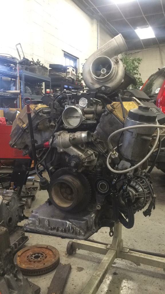

      With the start of my new buisness www.jayfabwerks.com I have been busy working and making other stuff for people. But I have been able to touch my motor a bit. Getting my driveshaft lengthend since the motor has been moved forward also after doing the manifolds I needed to get them decked since they wrapped a bit when welding. And finally I'm still waiting on my custom flywheel to be finished and it's close!

        • Tjabo
          • Feb 2015
          • 57
          #124
          Why did you weld up your IAC valve hole? Do you have another means of idle speed control, or go without?
          • driftingminor913
            • Sep 2011
            • 358
            #125
            Control it manually with the adjustment screw
            Because V8
            http://www.r3vlimited.com/board/showthread.php?t=282219
            Doing it wrong since 91:wgaf:
            • Tjabo
              • Feb 2015
              • 57
              #126
              Cool, how much variance do you have between cold start and warm idle? Or do you just give it some throttle to help it warm up?

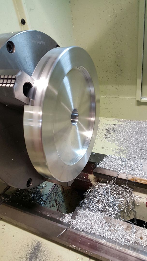

                Throttle to warm it up, got another pic of the flywheel

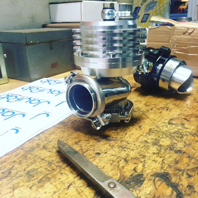

                    Sorry for lack of updates, been busy working on everyone one else's projects. Got some go fast parts in last week. Just need a couple more crucial pieces the puzzle then should have everything together in a weekend or so
                    Did some messing around on some utility blades.
                    Got to weigh the flywheel when It was done out of the Lathe, 15lbs!

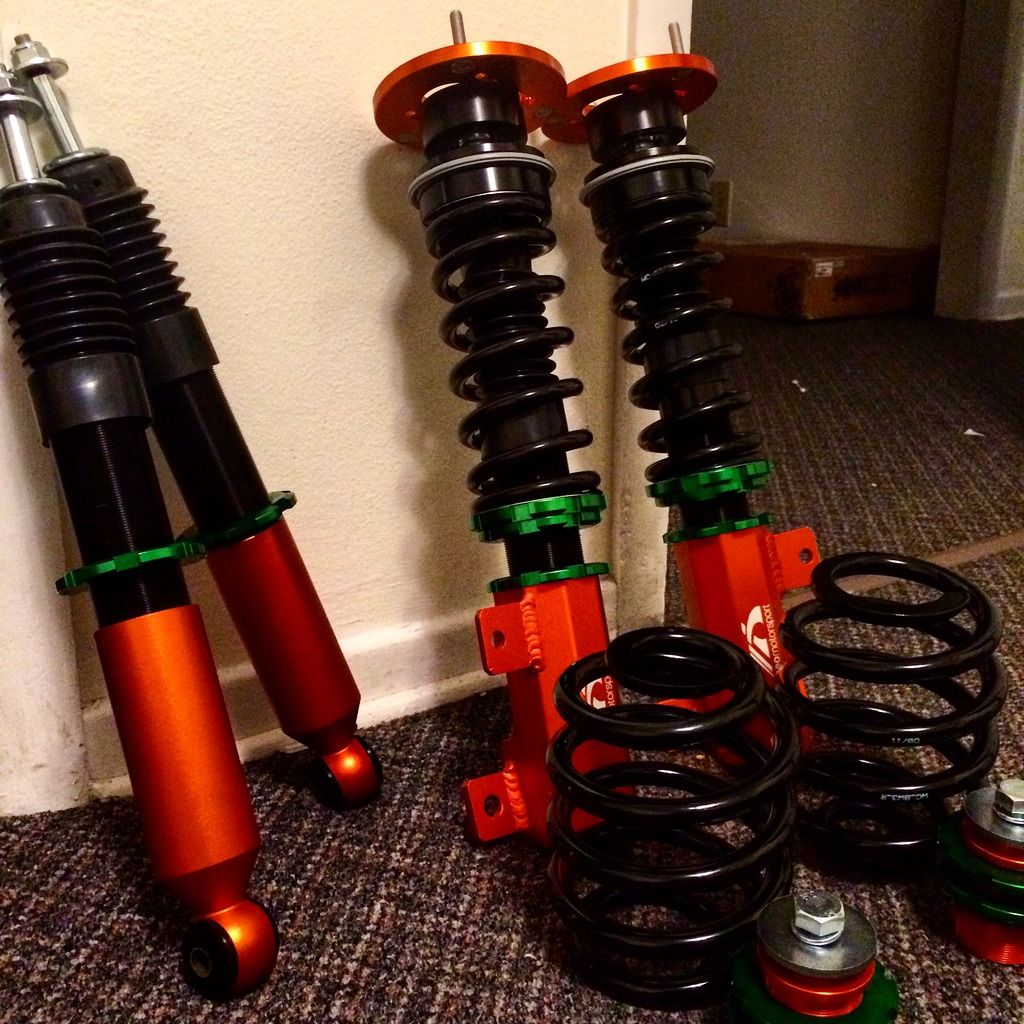

                      Picked these up also, which I'm stoked about
                              Congrats on this, BTW -- WAAAAAY harder than it looks. I don't think most people who haven't ever tried it would have any idea how hard it is.
                              Did you take a little bit of the razor edge off of them to butt them together, or did you manage to just get the filler to hold the edges in shape?
                              • driftingminor913
                                • Sep 2011
                                • 358
                                #135
                                Ok cool I will hit him up, and no I just wiped off the oil that comes on them and fitted them perfectly together and tacked n welded them
