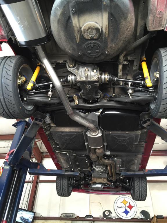

    The x pipe will give it a more modern v8 sound with a little higher pitch, plus some extra ponies also.
    Whats not to love, now i need to figure out where to put it ..

      Does your magnaflow muffler have a built in x pipe? The dual in/out magnaflow I was looking at did.
        Honestly don't know if it does or not..

          get a rattle can and shoot some everyday household enamel paint on your exhaust. drive it around, get it warmed up. put the car on the lift and look to see where it burns off. choose the spot as close as you can to where the paint burns and where it does not.
          another choice would be to put it towards the front of where the factory e30 cat would be.
          as far as your exhaust goes. it looks pretty good. i don't think it looks very factory, but perhaps that isn't the look you are going for anyway. what you have there looks like it would be really really loud. have you thought about resonators?
          i think i am going to choose the borla dual 2.25" and space the tips closer together so they don't rub on the edges of the bumper exhaust opening.
          I want my exhaust to look more like jordan's except 2.25 or 2.5" dual all the way back

            I have a different muffler a 24" can with built in x pipe, and dual 2.5 all the way back and its super quiet. So yours shouldnt be too loud.

              The exhaust came out great, what size is it?.... I cant wait to see a video of your car.
              Correction: I double checked and confirmed that the exhaust is 2.5" piping. I was mistaken when I said it was 2.25 early last week. FYI
