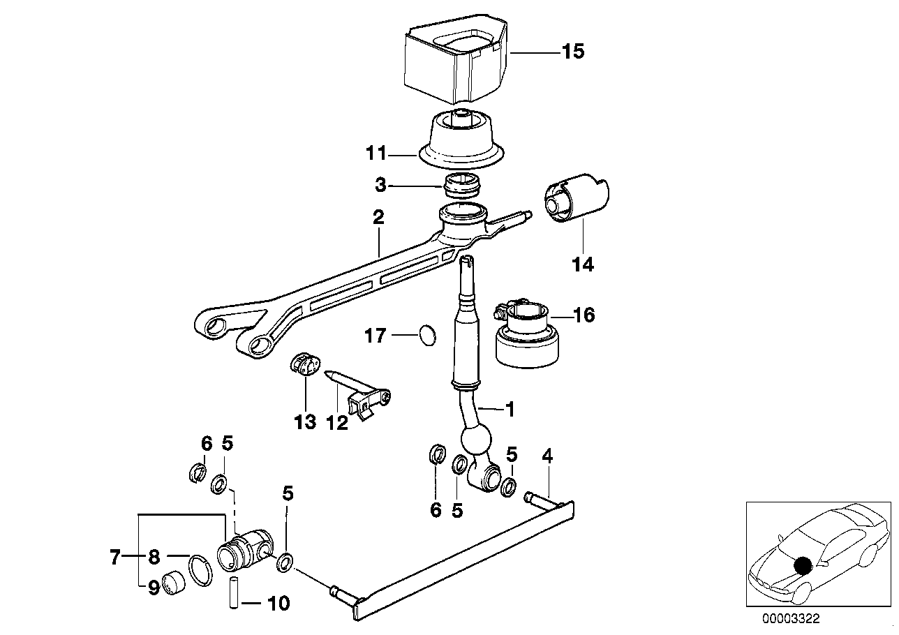

5) Lastly, since I need to order all the shifter parts for the car, I want to make sure I'm not missing anything. Again I am under the assumption that everything should come from an E39 to match the transmission. Here is the diagram from realoem regarding the E39 shifter assembly:
I purchased the E60 short shift kit and I have a DSSR that I will be shortening to size. I still need to buy#2 (Shifter arm, then shorten) #11 (rubber boot) and #14 (Shifter Arm Bearing). Now forgive my ignorance, but obviously one end of the shifter arm bearing mounts onto the shifter arm, but where does the other end mount to? Should this bearing be E39, or does an E30 one fit better?
