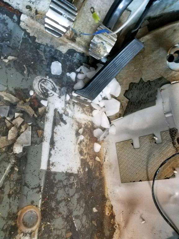

                  I stripped all the sound deadening the other night. 5.5 hours of back breaking, hand smashing (gave myself two blood blisters with hammer and chisel) work. I started off using a mixture of dry ice and rubbing alcohol to get the deadening super cool. It worked great but the mess of the rubbing alcohol wasn't worth it. I went back to using straight dry ice. I've removed deadening from lots of cars and it normally comes up in nice sheets or it breaks easily if hit with a hammer. Not this stuff. I used a hammer and a chisel and it broke apart into a million little pieces.
                  The deadening on the blower cover actually came off really easy with just the wire brush. No dry ice needed. If you do this, do it outside because it makes a HUGE mess and there is lots of dust.
                  All in all, I'd guess there was 50-60lbs of sound deadening? The stuff in the trunk was super thick and weighs a ton.

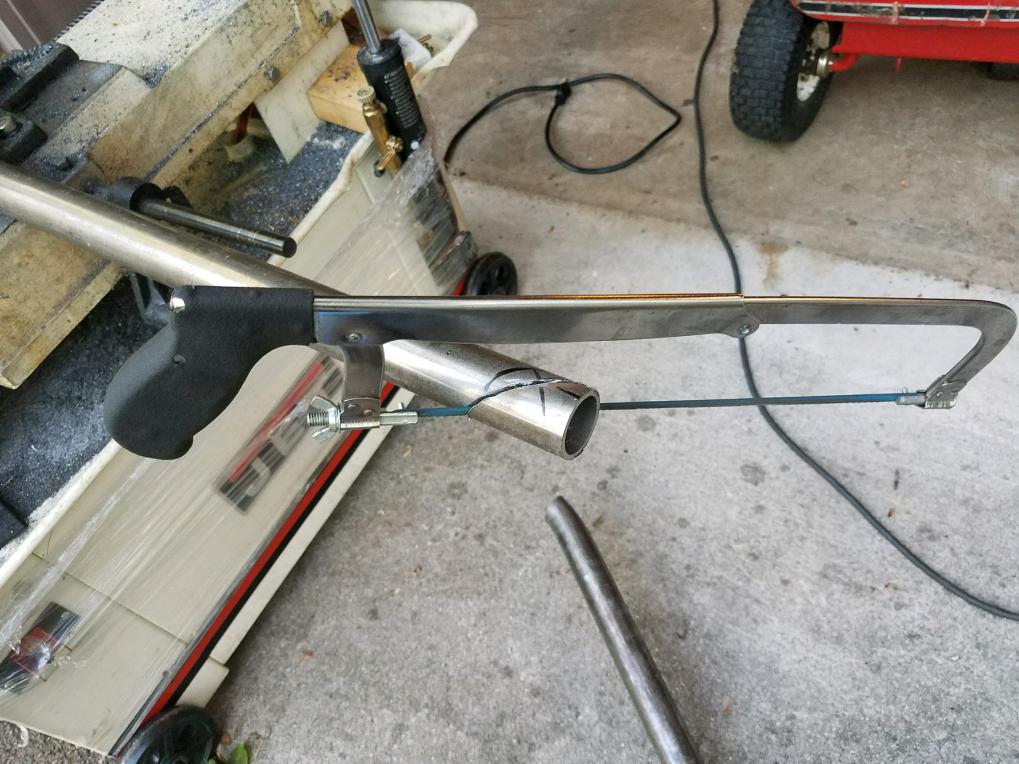

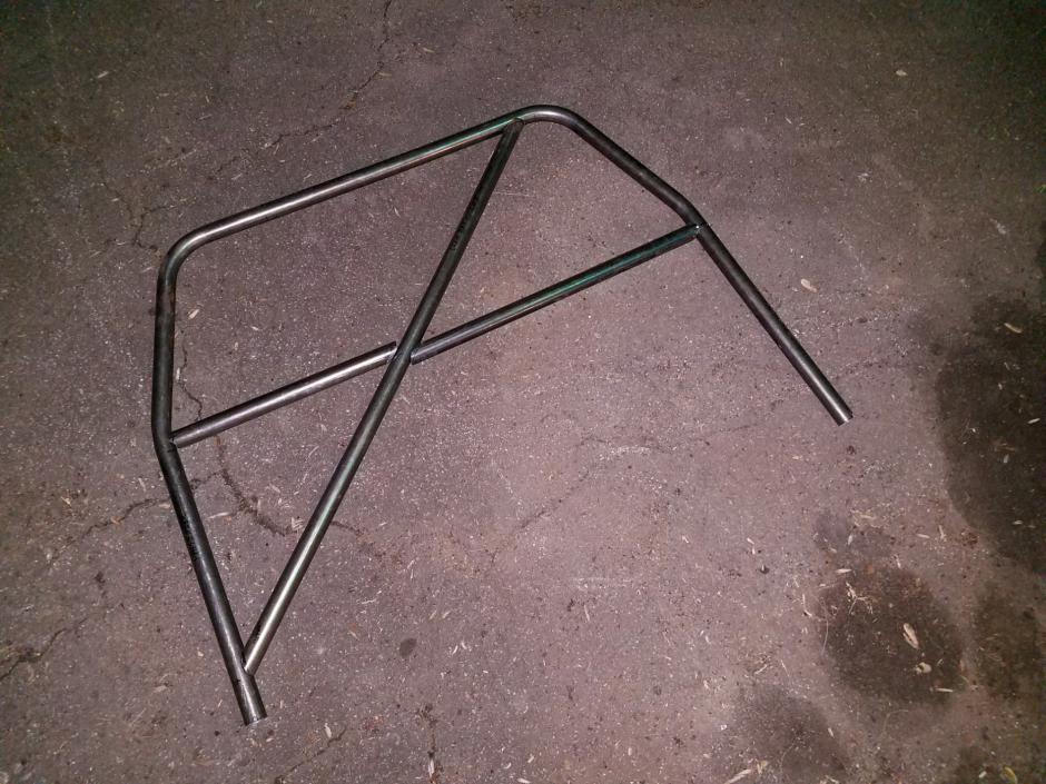

                            Worked on the cage some more.
                            Very useful website for bending tubing --> www.benditonline.com
                            My chop saw wont do any angles past 45 so ever miter had to be done by hand. My sawzall worked great until the battery died which left me with a hack saw and angle grinder.
                            The pieces are not welded together yet so pay no attention to the offset of the belt bars, they rolled.
