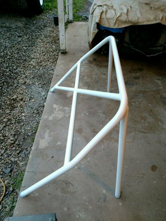

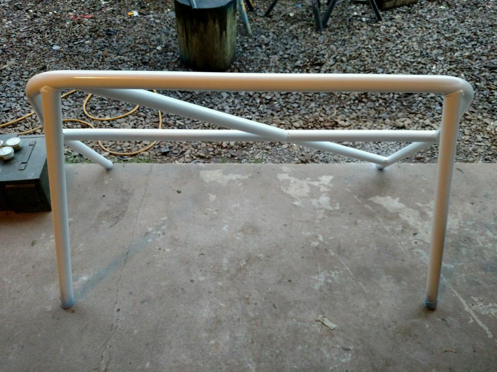

    Four point cage is DONE!

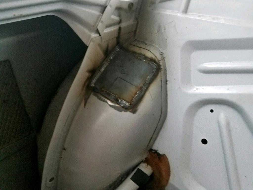

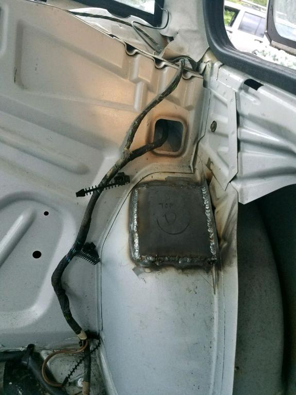

        The wheel house is a really bad place to anchor a cage... there's no structure there.
        The wheel house will fold like origami if that bar takes a hit in a rollover.
        • sgtskid
          • 761
          #94
          You know, I didn't even look at that....
          Edit: I started to look at it and was considering re-doing the bars but after doing some research I am okay with it. Kirkracing makes SCCA approved bolt in cages that attach to the wheel wells in almost the exact location. Looking through pictures of SCCA cages for both e30's and e36's there are lots of examples of the cages welded to the wells. The main load in a roll over is on the hoop; the down bars are to keep the hoop upright and the spreader plates keep the tube from punching/ripping through the sheet metal.
          The long term goal of the car will be to modify the shock towers to accept full coil overs and then add bracing down to the differential mount. At some point in the distant future I'll add the components for a full cage but since this will be street driven, I'll wait. Last thing I want to do is wear a helmet and knee pads to drive to work. :)
          Since the car will be 99% street (for the time being), I was more concerned with a solid anchor point for the shoulder harnesses.

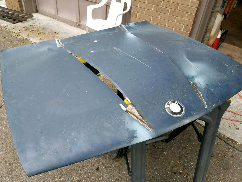

            The whole car was being done on a rat rod budget so why stop with the hood? I had a parts car with a semi decent hood (not so good that I felt bad about cutting it up) and I pulled it off and made it fit the engine. I still have the original white hood for the car and will eventually look at doing something with fiberglass. I'll wash the car and throw a coat of matt clear on the hood and call it a day.
