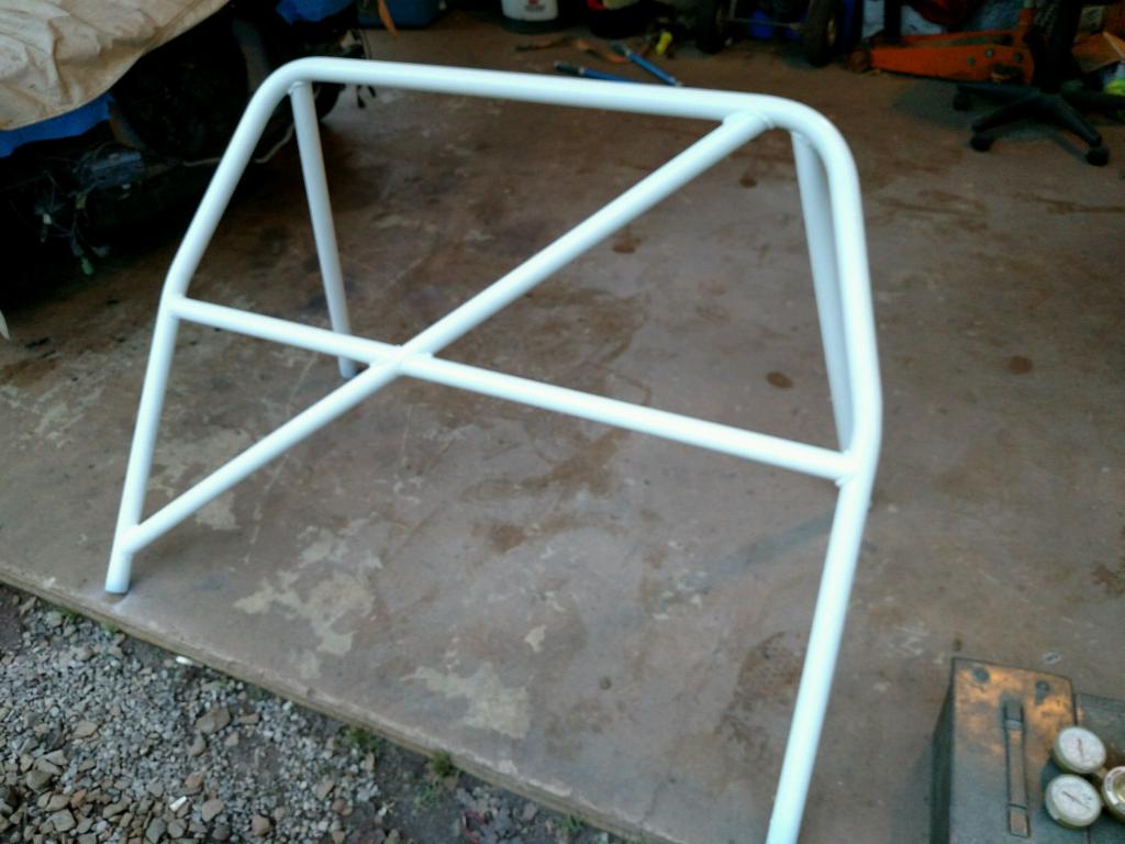

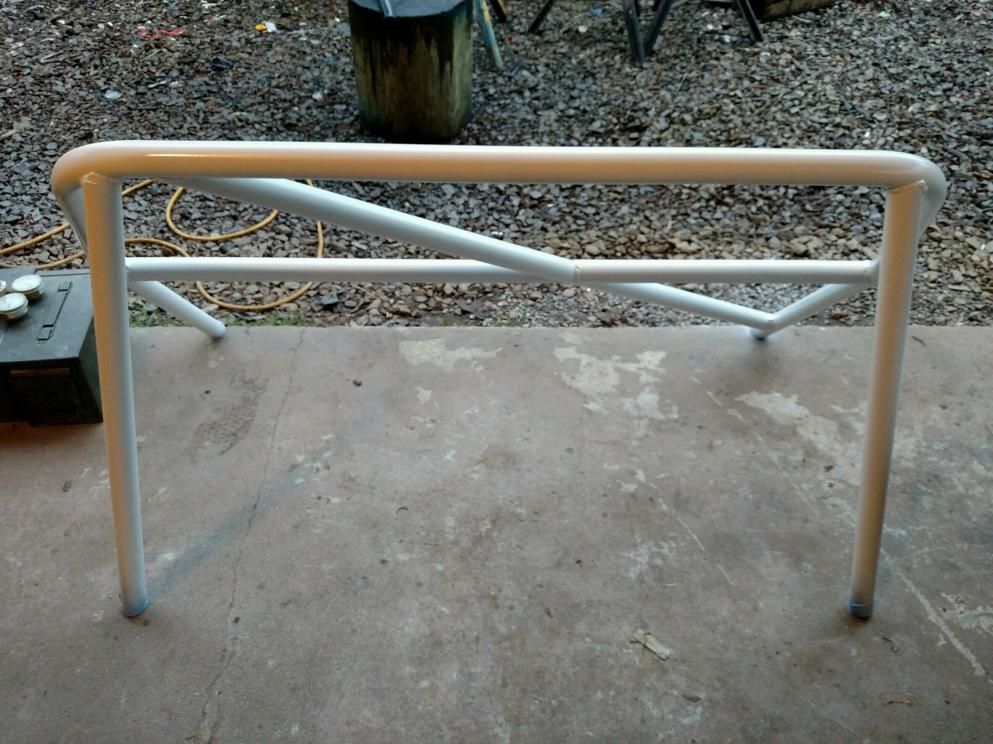

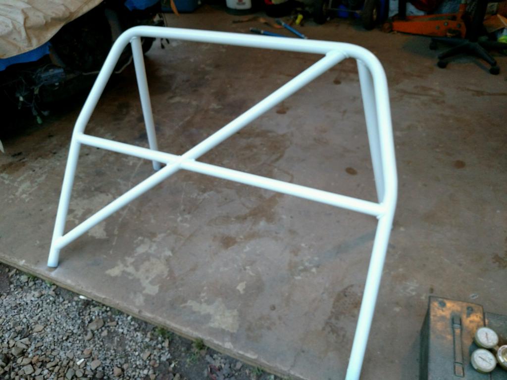

    Four point cage is DONE!

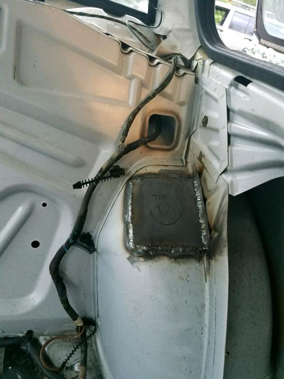

      • The Dark Side of Will
        • Jun 2010
        • 2796
        #93

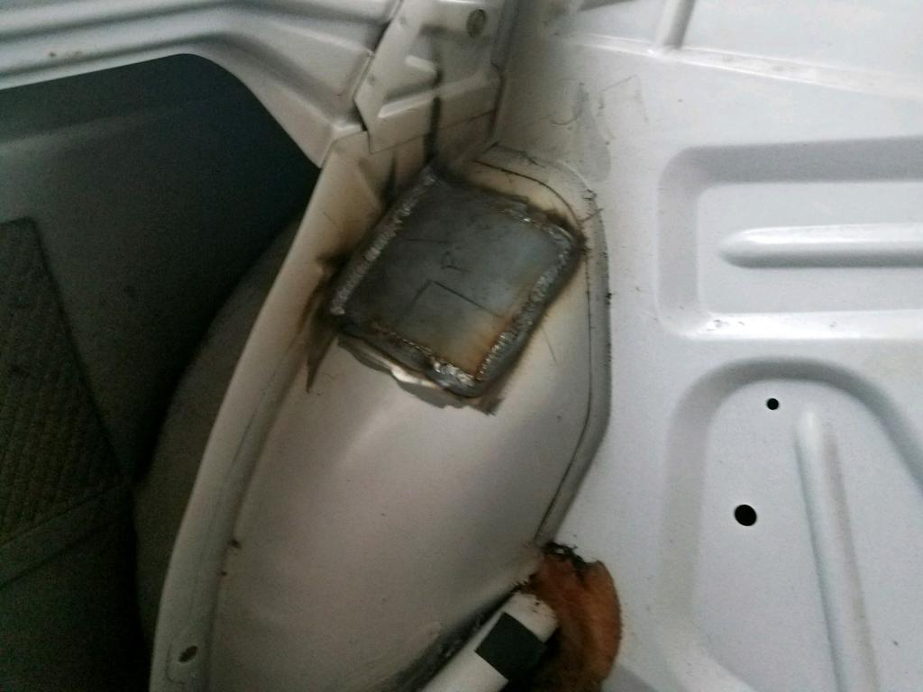

        The wheel house is a really bad place to anchor a cage... there's no structure there.
        The wheel house will fold like origami if that bar takes a hit in a rollover.
        • sgtskid
          • 763
          #94
          You know, I didn't even look at that....
          Edit: I started to look at it and was considering re-doing the bars but after doing some research I am okay with it. Kirkracing makes SCCA approved bolt in cages that attach to the wheel wells in almost the exact location. Looking through pictures of SCCA cages for both e30's and e36's there are lots of examples of the cages welded to the wells. The main load in a roll over is on the hoop; the down bars are to keep the hoop upright and the spreader plates keep the tube from punching/ripping through the sheet metal.
          The long term goal of the car will be to modify the shock towers to accept full coil overs and then add bracing down to the differential mount. At some point in the distant future I'll add the components for a full cage but since this will be street driven, I'll wait. Last thing I want to do is wear a helmet and knee pads to drive to work. :)
          Since the car will be 99% street (for the time being), I was more concerned with a solid anchor point for the shoulder harnesses.

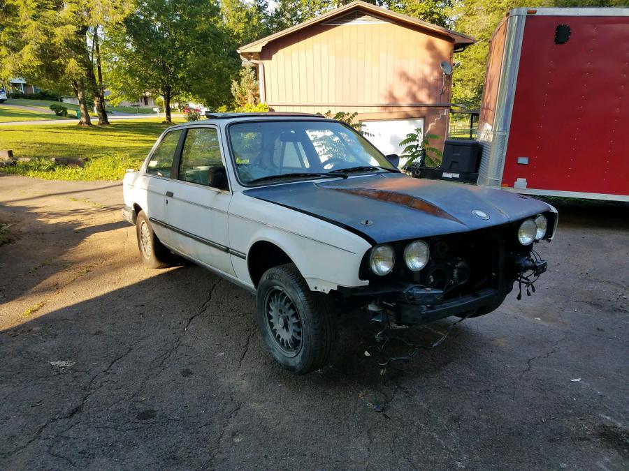

            Down to a very short list to get her on the road.
            1. Leaky TOB fitting - FIXED - Pulled the engine Sunday and installed it Monday and Tuesday.
            2. Tune - Scheduled for Tuesday next week
            3. Seat and belt installation - will do that tonight or tomorrow
            4. Alignment and Tires - scheduled for the same time of the tune

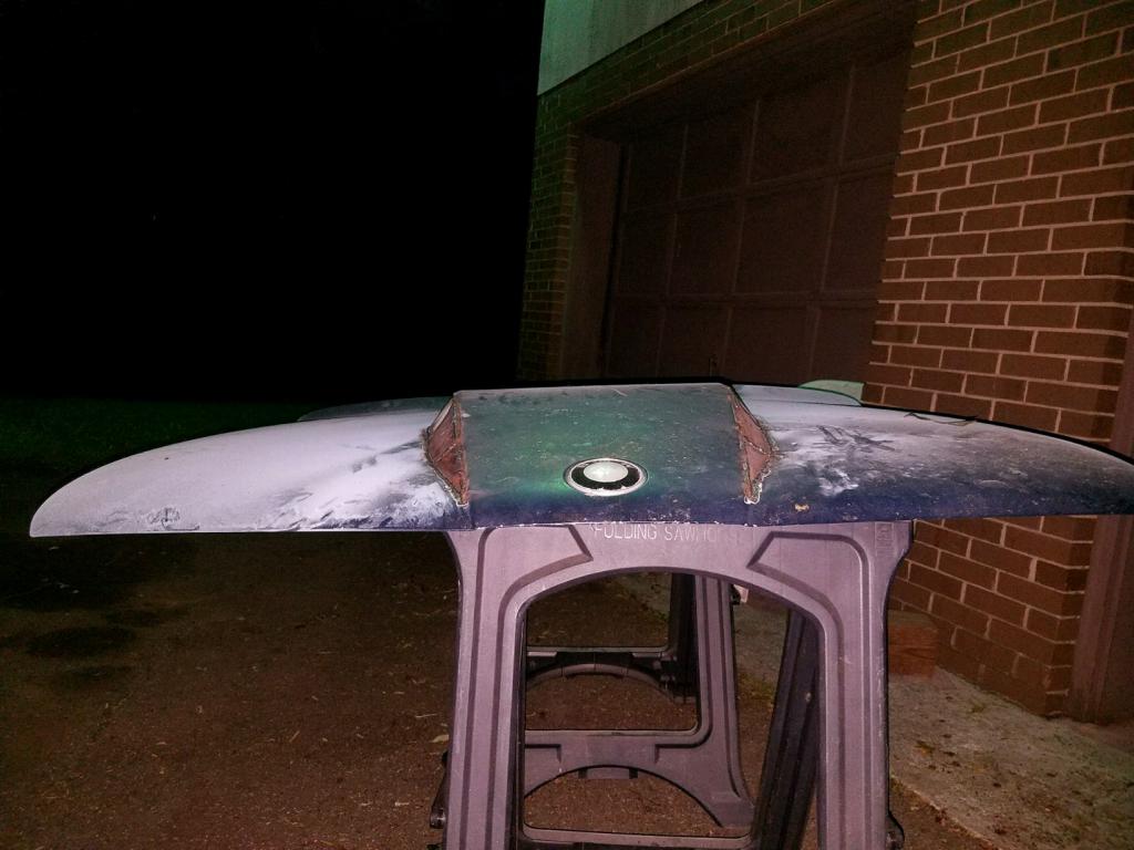

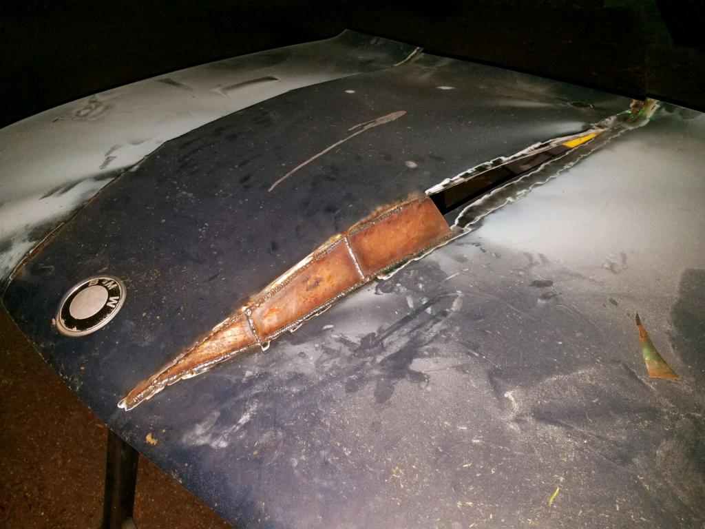

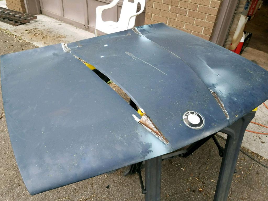

            The whole car was being done on a rat rod budget so why stop with the hood? I had a parts car with a semi decent hood (not so good that I felt bad about cutting it up) and I pulled it off and made it fit the engine. I still have the original white hood for the car and will eventually look at doing something with fiberglass. I'll wash the car and throw a coat of matt clear on the hood and call it a day.

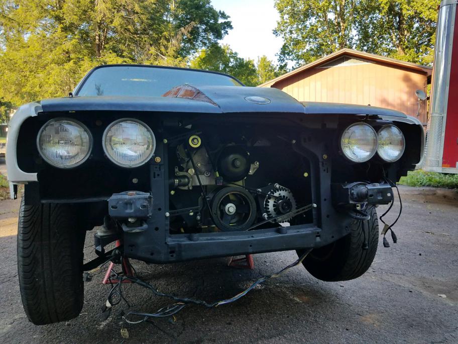

              #96
              [ATTACH]114332[/ATTACH]
              Current: '91 DS M3, '03 TS M3 (6MT)
              '06 Chevy 2500 Duramax - Race car hauler, '90 Corvette - Weekend toy
              Past: '88 AW M3, '87 RB M6, '98 CS M3, '88 DS M3, '88 Zinno M3, '88 AW SETA (facelift),
              1988 Super E (Bronzit - grey wrap)- RIP, 1986 353, 1986 VW Jetta (vr6) - Racecar
              IG: RDE_Fabrications
              Check us out
              Or YouTube --> HERE;
              • Q8y_drifter
                • Aug 2009
                • 297
                #97
                U need an idler between the water pump and alternator. You have very little belt wrap on the pump there.
                Alpine White 1989 E30 Coupe - LS1/T56
                • sgtskid
                  • 763
                  #98
                  I thought so too but I copied this routing.
                  I found the guy who's engine was pictured and he said he had been running several years with no issues. I also talked to one other guy on LS1 who ran his belt the same way and didn't have any trouble with it slipping. We'll see. If I have problems I guess it's back to the drawing board.
                  Here is another post with similar routing
                  https://ls1tech.com/forums/conversio...lt-number.html

                  • Q8y_drifter
                    • Aug 2009
                    • 297
                    #99
                    I'm running the same accessories as you and my belt setup is identical to this one here. Figured the idler was worth the peace of mind.
                    • sgtskid
                      • 763
                      #100
                      The trick now would be to space the idler out to match the rest of the pulleys. The 1/4" plate takes some planning. What did you use for the fixed pulley in place of the original idler?

                      • Q8y_drifter
                        • Aug 2009
                        • 297
                        #101
                        IIRC my idler (I had it laying around) came with a stepped spacer. It looked something like this
