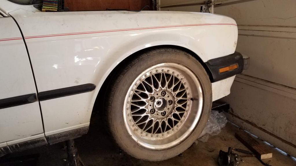

                  #83
                  These style 5's are too big at 17x8, especially with the offset of ET20, the nuts on the inside rim were scraping on the calipers.
                  The off-center control arm bushings were too much caster with the bigger wheels/tires also.
                  Click image for larger version  Name:	20190811_174844.jpg Views:	0 Size:	68.4 KB ID:	9864535

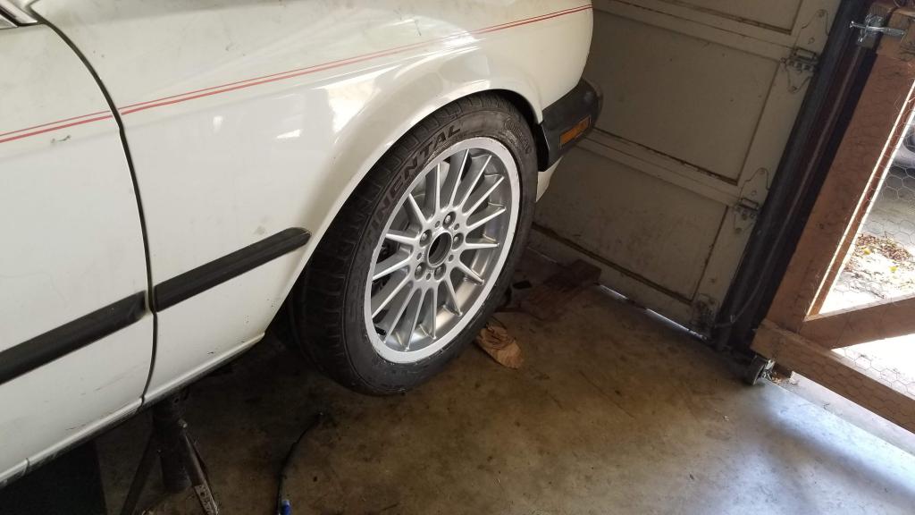

                        #86
                        Those 32's look so damn good on the E30. The rotors filling almost the entire inside is sexy AF too

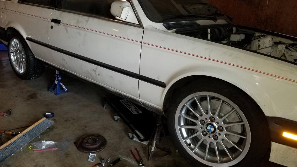

                            Style 5 vs 32... discuss

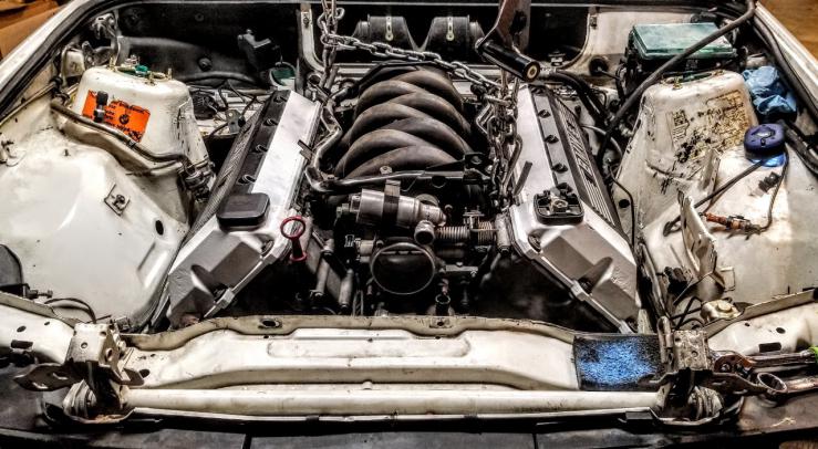

                                #90
                                aaand I finally did a test fit last night of just the motor and mounts!!! Seeing the M62 between the frame rails really reinvigorated me. I'm determined to get this done now!
                                I got it all tucked in by my damn self too. I got the bushings and bolts all lined up on my first 15th try.
                                Click image for larger version  Name:	20190825_212736.jpg Views:	0 Size:	74.2 KB ID:	9864553
                                Click image for larger version  Name:	20190825_212726.jpg Views:	0 Size:	76.1 KB ID:	9864554
                                Click image for larger version  Name:	20190825_212746.jpg Views:	0 Size:	75.6 KB ID:	9864555
                                My current E30 M62B44 swap
