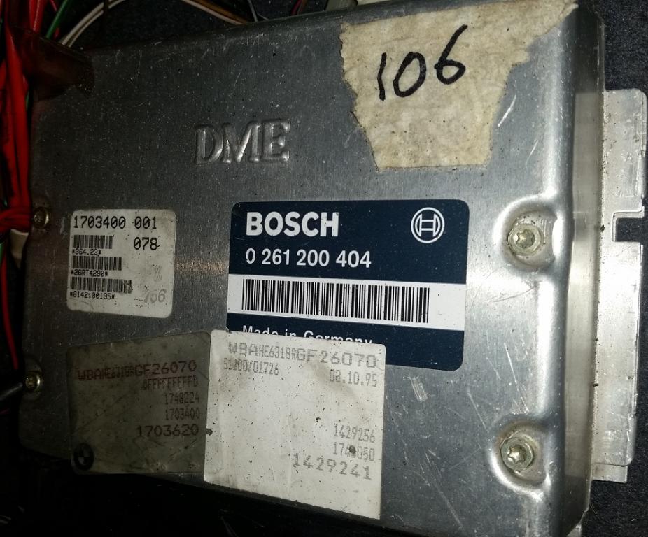

        Well, Verdict is in, It's an Automatic ECU from a 1993 540i E34. So I guess I need to think about getting a chip, or at least get this one reprogrammed to be a manual. Here is what a decoder told me. Sounds like the car that this one came from was nicely equipped.
        VIN: WBAHE6318RGF26070
        Type: Code HE63
        E Series: E34 ()
        Series 5
        Type: LIM
        Steering: LL
        Doors: 4
        Engine: M60/2
        Displacement: 4.00
        Power: 210
        Drive: HECK
        Transmission: AUT
        Colour: ALPINWEISS 2 (218)
        Upholstery: (0453)
        Prod. Date: 1993-04-29
        S214A Automatic stability control (ASC+T)
        S240A Leather steering wheel
        S245A Steering wheel column adjustment,electr.
        S279* BMW LM RAD OHNE
        NOTLAUFEIGENSCHAFTEN
        S459A Seat adjuster, electric, with memory
        S472A Armrest, front, driver/passenger
        S494A Seat heating driver/passenger
        S640A Preparation f tel.installation universal
        S686A Antenna-Diversity
        S694A Provisions for BMW 6 CD changer
        S818A Battery master switch
        S925A Dummy-SALAPA
