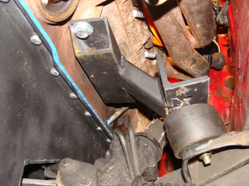

      I'm sure we've all had the rubber motor mounts fail, I've had several cars where one or both failed. I doubt that arm fails before a rubber or poly mount.
      edit: And let's not forget how sad the stock stamped steel M20 motor mounts are. And this is what people use on 302s:
        Click image for larger version  Name:	ypN4VfAMutXTGgS4UeDW4goynaNuu_KIfFI3KL98ZcQV8inxyQiBR7yeQ4QoR3y-GplI-T63VBZa7XWAJi8DTw.jpg Views:	0 Size:	65.9 KB ID:	9905388
        Yeah. At the end of the day, I'm just glad I didn't have to pay Sikky prices for my mounts
          I think the whole crux of this discussion is "the fact that people use them doesn't make is a good idea". BMW's M20 mounts have some engineering to them... and only have to handle 170 HP.

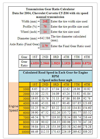

            I think we can probably get along fine if you're able to move on from the motor mount issue, man.
            Edit:IGNORE THE FOLLOWING. I thought I was reading mph but was reading kmh
            I'm going with a medium case -- 3.91 or 3.73 most likely, and I'm going to weld it. 4.10 is a little spicy for me, although I might try to slap one in at some point and see how I like it.
            Getting to any city around here requires a lot of highway driving, and I don't really want this thing revved out constantly when I've got a long drive home.
            I'm thinking the 3.91 is a great middle ground and should be at a somewhat comfortable rpm around 70-80 in 6th, assuming I have everything plugged in here correctly.
            I haven't really settled on wheels/tires yet, but I'm fairly certain I'll keep 14" for cheaper rubber. Just going on these size calcs until I make a decision.
            3.73:
            Click image for larger version  Name:	diffratio373.png Views:	0 Size:	272.4 KB ID:	9905563
            3.91:
            Click image for larger version  Name:	diffratio391.png Views:	0 Size:	264.3 KB ID:	9905564
            4.10
            Click image for larger version  Name:	diffratio410.png Views:	0 Size:	264.9 KB ID:	9905565
                LOL at the irony that you have to get the final word saying I should move on...
                LS != M20
                Your 3.73 with 53BZ option is going to have you turning 3500 at 80. Don't do that to an LS. Yes, people run 3.73's and 4.10's in LS equipped cars, but that's with the 0.50:1 sixth gear in a T56.
                Having that engine that wound up on the highway is going to get old fast--especially if it's loud--AND will give you terrible gas mileage.
                Camarobirds and Corvettes with T56 and 3.42 gears can knock down 30 mpg highway without much effort... AND they're still fast.
                Keep in mind the T56 has a 2.66:1 first gear while the 53BZ has a 4.01 first gear.
                I'd be looking at 2.79's or maybe a 210mm 2.65.
                  LS != M20
                  Man, I'm just not sure why you're looking to be such a prick about these mounts.
                  As far as the gearing goes, I'm surprised to find out you're actually correct about something. I didn't notice the top table was showing km/h.

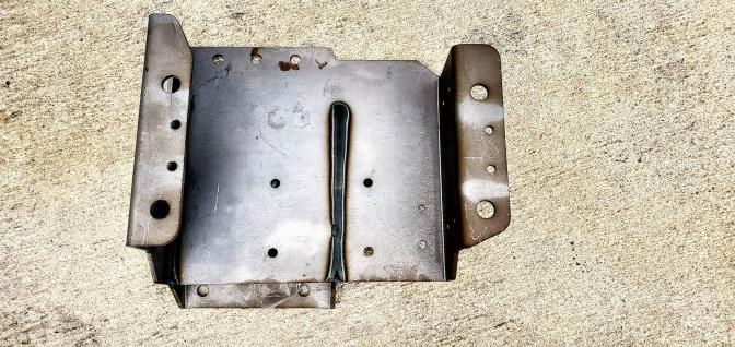

                        But I need to warn you - your worst nightmare arrived today . I'm afraid to even go near them without more gusseting. I'm concerned they might explode and send shrapnel into my eyes.
                        As soon as the UPS truck came, I could tell the neighbors knew I had improperly gusseted mounts in the package. I saw them whispering to each other about calling the police..
                        NASA was contacted. I'm told engineers have been dispatched.

                        Alex also hooked me up with an unpainted Wilwood Pedal Box Mount by Garagistic.
                        These fucking things are normally an unbelievable $600 from Garagistic. Dude picked it up on their black Friday sale
                        and gave it to me for $100.
                        Click image for larger version  Name:	4.jpg Views:	0 Size:	76.9 KB ID:	9905722
                        Click image for larger version  Name:	5.jpg Views:	0 Size:	64.1 KB ID:	9905723

                              So I just spent a bit comparing various setups and different gearing. I'm thinking the 53BZ with the 2.79 looks good. The deep 6th of the T56 is definitely appealing though for longer drives.
                              GS6-53BZ with 2.79
                              T56 With 4.10
                              Click image for larger version  Name:	4.1.jpg Views:	0 Size:	99.2 KB ID:	9905802
                                Click image for larger version Name:	1.jpg Views:	0 Size:	68.0 KB ID:	9905719
                                Click image for larger version Name:	2.jpg Views:	0 Size:	63.3 KB ID:	9905720
                                Click image for larger version Name:	3.jpg Views:	0 Size:	70.2 KB ID:	9905721
                                Thank God. Finally. If they'd been involved from the get-go, the mount arms would have the right gussets on them. As they are, they're gusseted to keep the engine in place when crashing into things, which I guess is one of the main features of drifting.
                                Those are definitely nice stacks of dimes, but in actual structural welding, overlapping beads is a no-no because the extra stress the second weld puts into the material around the first bead sets the best conditions for a fatigue crack to form. That mount arm is probably ok, because the overlapped beads are "in the middle" and not subject to the highest stresses... but just because it's pretty doesn't mean it's good. The gusset that is there should have the inside corner hollowed out so the beads don't overlap.
                                It's not just these mount arms. I see sooooooo much stuff in the automotive aftermarket that is just silly from a structural perspective. It's especially evident in roll cages... If the builder doesn't follow some pretty easy design rules--and so many don't--the driver is still at risk no matter how pretty the welds are.
                                A few years back I saw a magazine article about a shop putting a C5 Corvette driveline and suspension under a '60's pickup truck body by building a custom frame. The frame was 4 members of mandrel bent steel tubes with laser cut shear panels in between to form two frame "rails". The problem was that the rails were basically flat and the structural section height couldn't have been more than 3 inches... so the fact that it was designed on a CAD workstation, cut with CNC equipment and welded with God's own TIG torch did not matter one bit because the design was hot garbage. No matter how well the builder built it, it was literally impossible for that frame to be anything but a spaghetti noodle... and yet the customer must have received a 5 figure invoice just for that.
                                You should spend some more time wrenching on your car so you build up some callouses and your skin isn't so thin.
