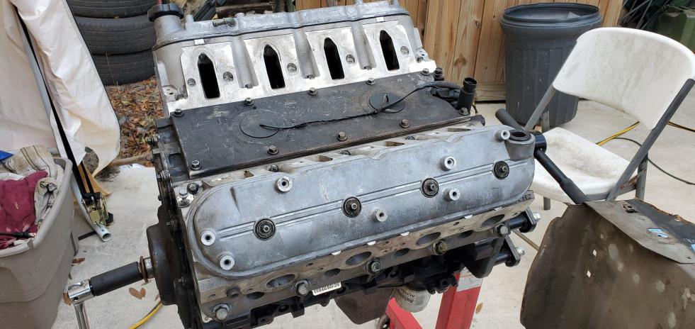

                Got the heads back on and torqued down. Closed up the valve covers, but I still need to order a trunnion kit, so rocker arms and lifters aren't back in yet. I'm hoping to get the oil pan on tomorrow or Monday so I can put my mounts on and plop this baby in the engine bay.

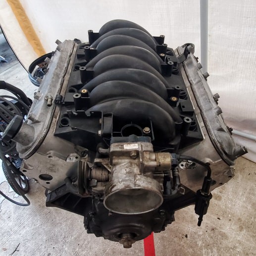

                  Really loving how this is coming together. Picked up a LS1 Intake manifold with throttle body for $140. Scrubbed it with some purple power and a toothbrush then blew a lot of compressed air at it to get the grime off. Have new gaskets on the way.
