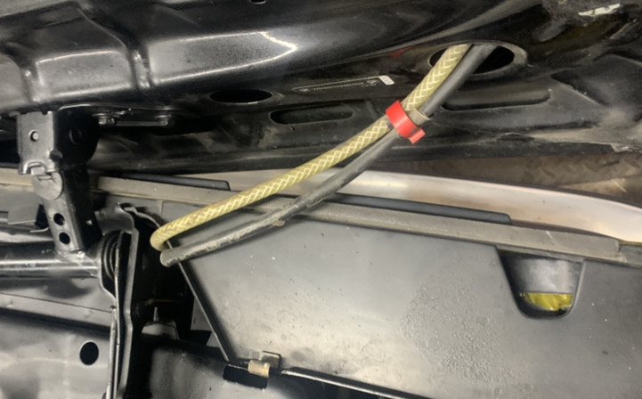

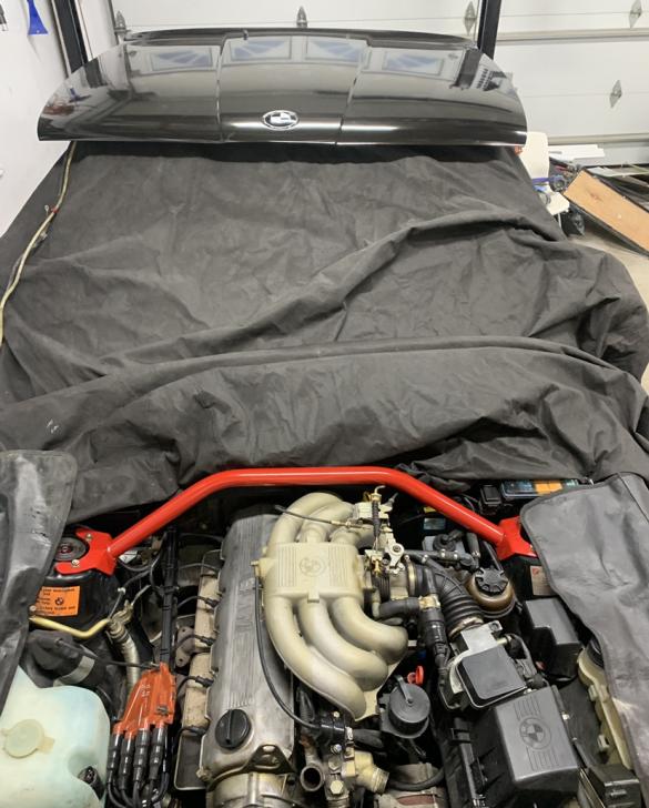

    Hi,
    I started the process of timing belt replacement and want to remove the hood for easier access.
    everyone says disconnect the washer hose but I don’t see how plus I have wiring going to the hood.
    how do I disconnect the washer hose AND the wiring to be able to remove the hood?thank You

    You can keep hood on. Its not that bad.

      It’s removed had to disconnect the wires and the line from the source.
      Hood is out.

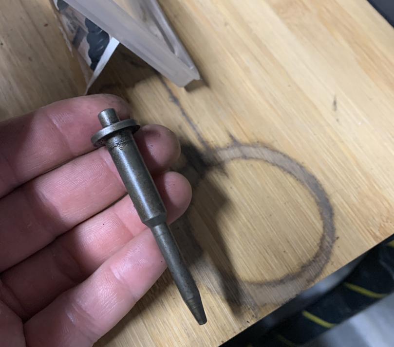

      i have removed components up to the water pump and while removing the water pump this pin fell off.
      i didn’t see from where and in none of the instructions I see this pin.
      can someone advise what is this pin for?

        Fairly certain that is the timing tensioner pin. Part 19 on this diagram. Please keep updating this, I need to know how this job turns out.
        https://www.realoem.com/bmw/enUS/sho...diagId=11_4365

          Thank you.

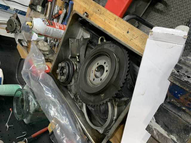

          so far running good all parts coming off nicely.

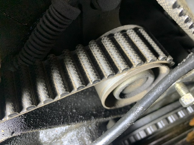

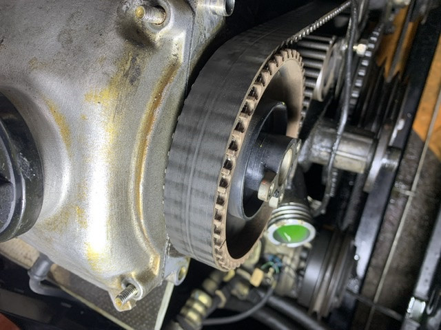

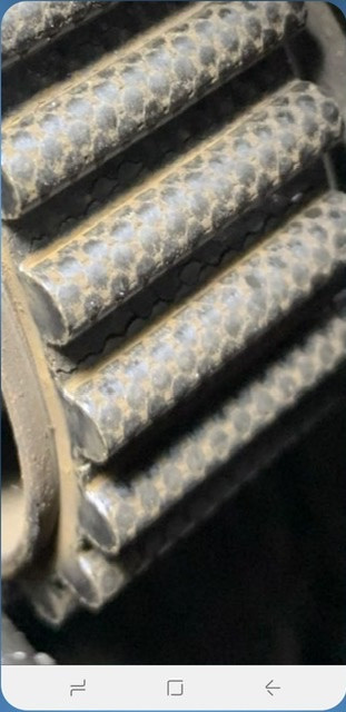

          It looks like I might have avoided catastrophe, as the timing belt looks old. I bought the car last fall and drove it for about 200km before doing all the maintenance.
          More updates to follow.
