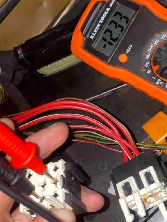

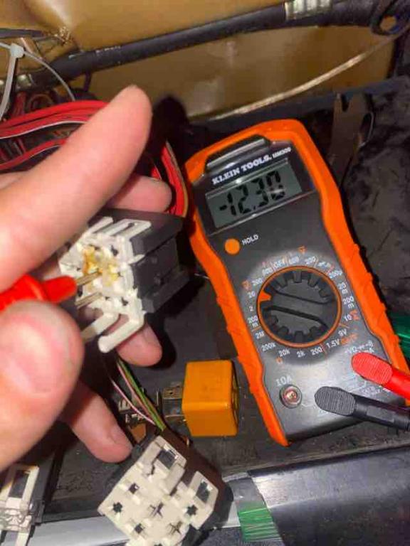

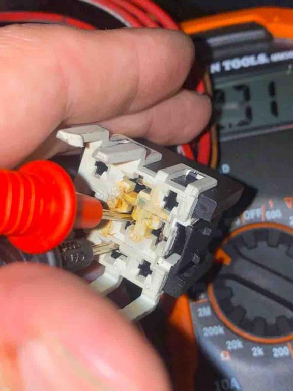

Have 11.87 volts to fuel pump relay with key off. 11.87 volts to center relay with key on
e30 M50 code 1264 after fixing no start issue. May have cut a wire
No power to fuel pump unless I jump relay or squeeze it with the cover off
assuming dme is not groundedComment

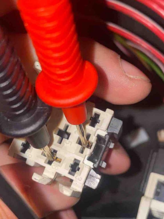

soo I have power at dme relay and fuel pump relay plug
constant power at fuel pump relay, dme plug for relay has no power when key is off power when key is on.
I'm double checked wiring one wire is loose and needs a new pin ill post what my wiring colors and pins are rn

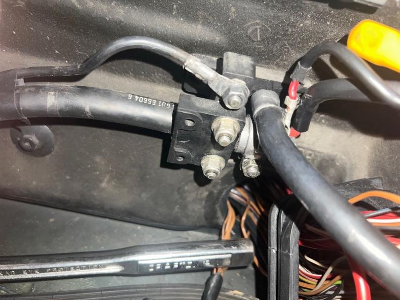

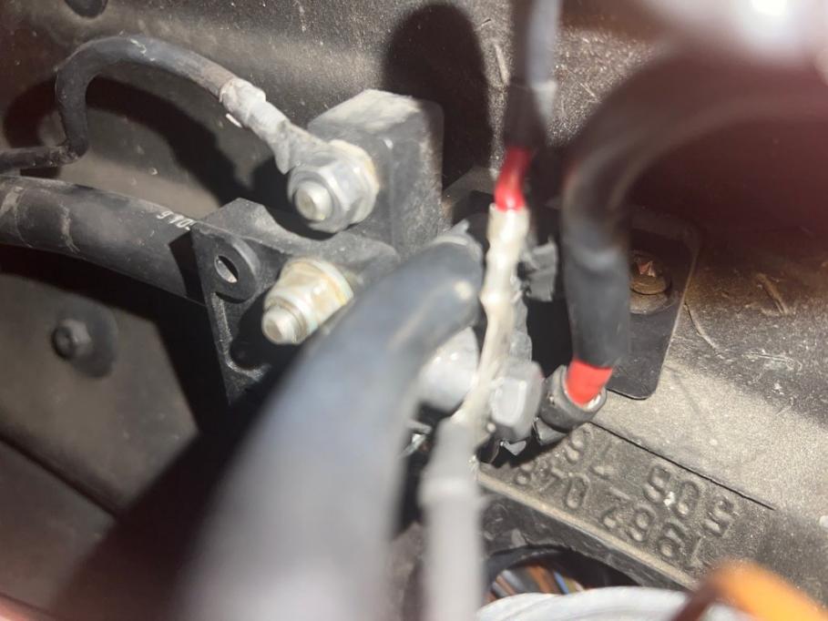

I took this engine wiring cover off by cutting it out and I then tucked the wiring harness over the eco and pulled it in to put the relays tucked and the cover mounted in the glove box cleanly, after I did so. I lost Cel light, fuel pump prime, and, I went through some things light if figured out I have power to the relays , but I'm not receiving power to fuel pump but will if I jump the relay, but won't get any Ignition, iv checked my grounds, and powers and I believe I have everything in the proper place, I think when I unwrapped my c101 connector I have pottenilly 2 wires pulled out, or I had two just sitting in there and I forgot I taped them up , soo I put them in the designated wire hole. soo I still don't receive signal for check engine light, if I jump the fuel pump relay I spray gas under the car from to much pressure, the car is fucking with me, soo there's a burn on one of the relay plug I posted picture , I don't believe the relays are firing, I've taken good relays from another car I know works, so I don't think the relays are the problem, I I really need help with a direction, to go, im about to buy another harness and restart, I had this car running before I took a wiring harness cover off of the original harness plastic shield,/ mount, and installed it under the e30 m3 wiring harness ,
soo is it more possible I damaged a wire by pinching it. ive tried to go through everything , im about to remove the harness and go through harness again, properly, and redo the connector by pushing each pin out , and plugging them in manually and then reconnecting it ,
any advice would be awesome as im really struggling with some advice on a direction,
if someone could help ill pay them 3102996047
call or text me
