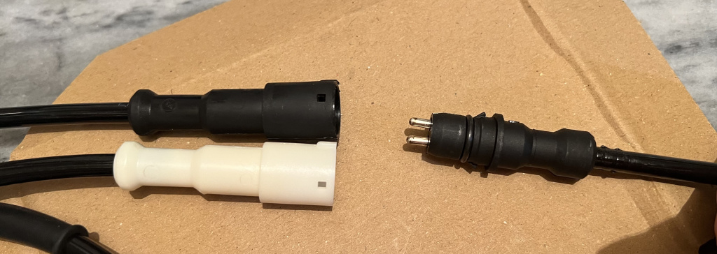

        Do you happen to have any pictures for side by side comparison? I'd like to replace mine also as they have crumbled apart.

          Here is a picture of the haldex connector (both black ones) and a new Bosch speed sensor (white). I don’t have a picture of the original connector.
