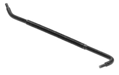

      If a valve job or valve grind has been done to the cylinder head, Or and aftermarket regrind.. It can put the eccentric in an odd location.
      They sell a springy tool that has 2 ends on it that I got from BAV auto 20 years ago that has been working well.
      Something like this.
      https://www.pelicanparts.com/More_In...tm?pn=TOL-3013
