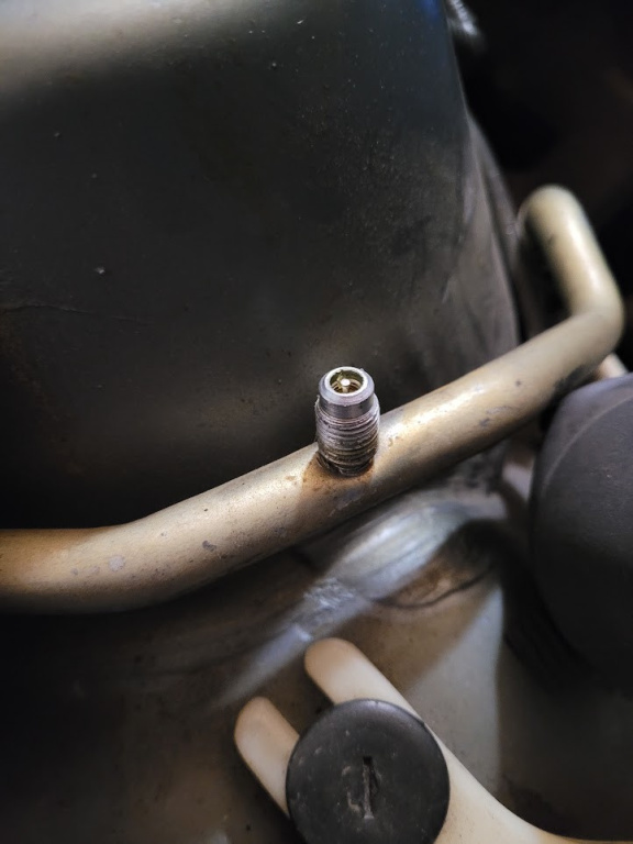

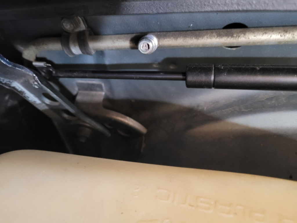

          Originally posted by monty23psk
          What do your charge fittings look like, this is 95% the way to tell which charge you have.
          Here are photos of the fittings. I'm guessing these are stock R-12 valves. Can you confirm?
          • monty23psk
            • Mar 2008
            • 1289
            First pic of it by shock tower is old r12 fitting. The other on the inside of fender looks to be r134a, but probably r12. It is a bad angle to tell. Do they look the same? You can still use r134a with the old fitting but very rare to see that.
            Alex 88 m5 | 91 318is | 19 Subaru Ascent
            BMW Tool Rentals & Fender Roller
            • blastcaves
              • Nov 2023
              • 20
              They are exactly the same. I'm going to assume I still have the R-12. Thanks for the help!
