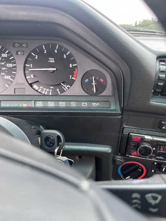

    this is after 15 mins of idling right now from a cold start. Pulled the car out of the garage for first time today and just let it sit and idle. It only goes over the middle line if driven around all day and then let it sit and idle. Am i being too OCD?

      looks good to me.

        I’m a GOON!! Aux fan resistor is dead again. I just replaced it last year so that’s annoying. Anyway yep temps in Austin are 92 F right now and I’ve been running the AC and that’s when the needle sits on and passes the center line verryyyyy slowly. Needle stays below the center line with AC off (like in the pic) or with heat on while idling all day long. Can this thread be deleted?

          Yeah that looks totally normal for clutch fan only. My car with working aux fan vs my car with broken aux fan represents the exact difference you're experiencing.
