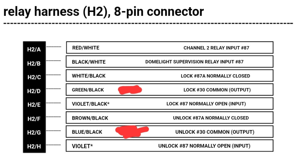

    Green and Blue are commonly Lock and Unlock wiring from the Alarm brain to central locking unit.
      Think you are correct... just have to see where they go into the chasis now

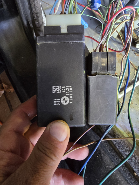

        Ok narrowing stuff down.... have to find the pinout to this. Looks like 1 wire goes to central locking on the accesory c302 so ill start looking there for pinouts
