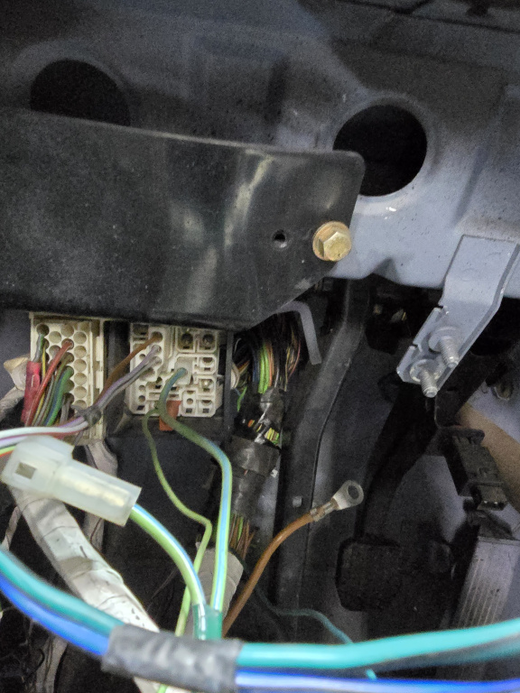

    What is this underdash wiring called?
    I will absolutely look at the diagrams to figure out what each wire is.. but I cant figure out what to search to find these underdash pinouts

    Below is a link to the uber electrical manuals, and it points out what connector is where. C101, c102, c103 etc.
    there are diagrams in these manuals of the car and they point to all the connectors, then you look up that connector and it gives the pinout and colors etc.
    The manuals are quite overwhelming at first, but they contain so much information.

      I did download this already but havent looked on the computer to dive in... hard to see anything on the phone.
      It would help if I knew where to start with the white junction boxes on the interior firewall area with what they are.
      no one spoon feeds here I get that... just hoping for a bone on where in the manual this might be

        well at the very least tell us what year your car is and what model...

          Sorry.. 1989 e30

            The square one on the right is C302, the accessory connector. This provides power and ground to the radio, power antenna, cruise control, power windows and ABS. See page 8500-1 of the ETM.
            The rectangular connector on the left (C103) connects the dash harness to the chassis harness.
              You are the man.
              Since this is a drift car no accessories needed so ill figure out the window wiring and call it good.

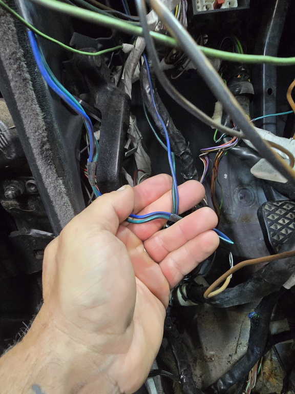

                          Ok hopefully just this last one
                          These 2 wires seem to be cut(viper alarm maybe) but go into the body
                          If you know what they are that would be awesome. Im digging through the etm looking for the colors right now

                            The colors and gauge of the wires you are holding are not familiar to me and I am certain are not present under the dash of my 1990 325i manual. I recently removed the dash and HVAC unit as part of a major renovation project and I would have seen such wires if they were present.
                            Presumably, these are after market wiring such as an alarm or radio. Do they go to pin V, W, X, Y or Z of the accessory connector (C302)?

                              They dont go to any pins.. they go into the chasis kick panel. They looked fairly big to be stock... ill tracke em down... maybe someones speaker job
