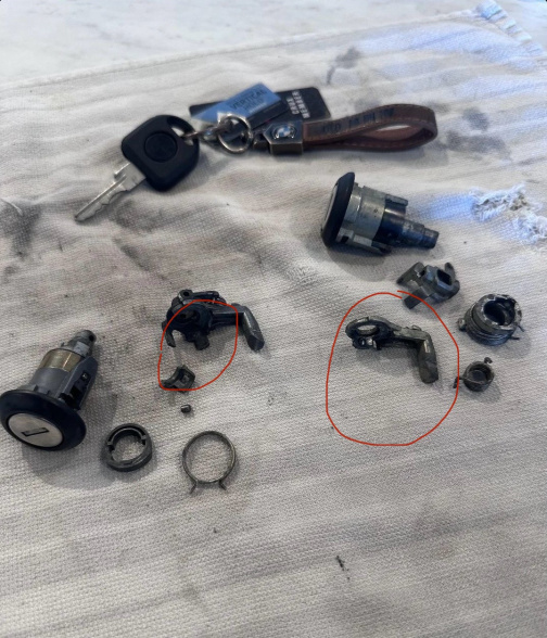

                        The only part that breaks and renders the lock useless can be replaced with any healthy drivers lock cylinder. It’s that flimsy metal layer that holds the ball bearing. I took another cylinder I found in a junkyard and replaced the metal layer (red circle) with the broken piece in my cylinder and good as new. You do not need to take the whole cylinder apart just the top three layers. Not sure why the repair kit came with the tumblers and all other parts?
                          Do you know if these parts can be scavenged from either side? or are they driver side specific?
                            Hi Nadodude, that exactly the piece that broke on mine, I'm gonna try and do exactly what you've said, complete barrel only cost £20 off Ebay, this weekends job for me.
