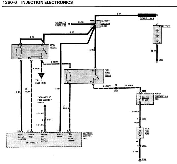

                      Waiit a sec, the main relay and fuel pump are turning on without the DME?
                      Ah ha, look for modified wiring over at the main relay. Maybe someone tried going from C101 Pin 7, right to the relays. That would explain a bit.
                      It SHOULD go to the DME first, straight from the ignition, and the DME directly controls those two relays, once it sees the input from the ignition. (Weird, but it's how they did it. Think amp remote turn on wire)
                      Here's what the main relay and fuel pump wiring should look like, note no ignition switch input. Strict DME control. If they turn on without a DME.... There's where the problem might be.

                        I'll check that relay wiring, but ALL the engine bay wiring came off of a running IX. It should be good. (thanks rede30!)
