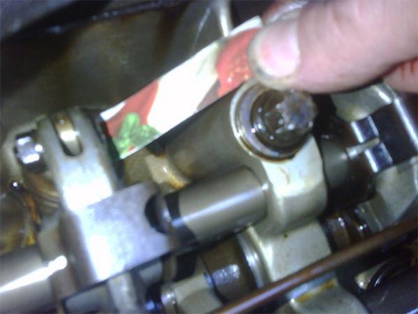

        Do it with a herring can lid, use other side after 6th adjustment (compresses too much on 12):

          ^ The tool is so cheap... and with your valves, I would think you want the gaps to be consistent and accurate. With a feeler gauge you can adjust to the right gauge then see if the next size up won't fit go - nogo style.
            #35
            It works well when you can't find your feeler gauges and you just ate herring.
