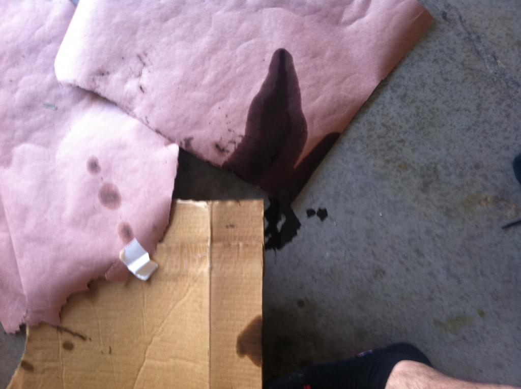

    hey r3v, so i woke up this morning..moved my e30 to the driveway, came back and saw this big spill.. it wasnt there yesterday.. i changed my oil not even 1000 miles ago , ROYAL PURPLE oil, please let me know what is going on. thank you (attachment below)

    Pic

      Lots of places
      What kind of oil. Motor,tranny oil, powder steering fluid, brake fluid? Look on the under side of tha car. A picture of an oil spot does not help unless you could explain where it is I respect to the car parked above. (under the front of the motor or rear of car.

            if that is motor oil its very dirty
              motor oil, royal purple

                Hard to help with the little info you are giving. Lots of places oil could be leaking. Probably best to get under and investigate. Front of engine, rear of engine look around.
                  I just figured out that i need a new oil pan gasket , it gave out

                      If you've got a high mileage motor...
                      ...and swap to synthetic oil this is very common.
                      The detergents in the syn oil will remove any sludge acting as a dam or barrier to a compromised seal or gasket.

                        Check your oil cooler lines to the motor. They have a tendency to back out over time. At least, they have for me.

                              bad pan gasket should leak that bad,look like front main seal went bad.
