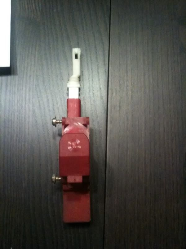

          new actuator is $70-80, its located in door right about 6 inches below the keyhole.
          Its a bitch to get to so I hope you have skinny arms. I had issues where I couldnt lock drivers/passeger door even by force. Just replaced my drivers actuator after checking everything else and that solved problem Have to replace my passengers also.
          Also check your central lock mech.
          Note. the actuator for a cabrio is DIFFERENT from a hardtop
          Renting my rear wheel bearing tool kit. SIR
          http://i25.photobucket.com/albums/c5...ps6debf0b0.jpg
