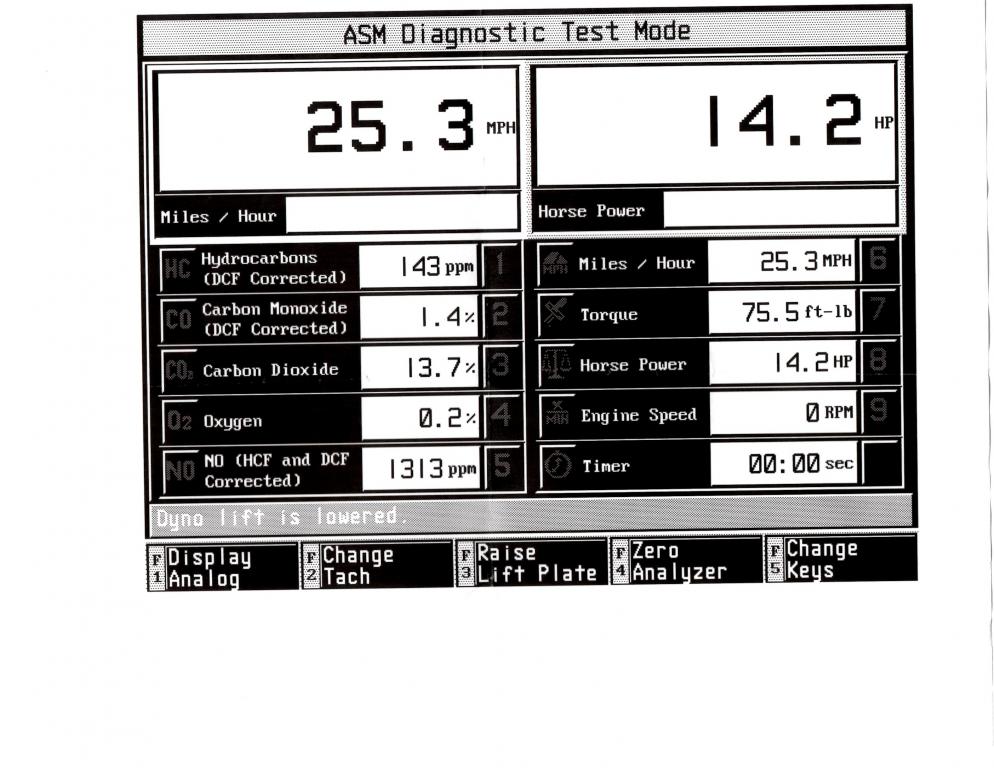

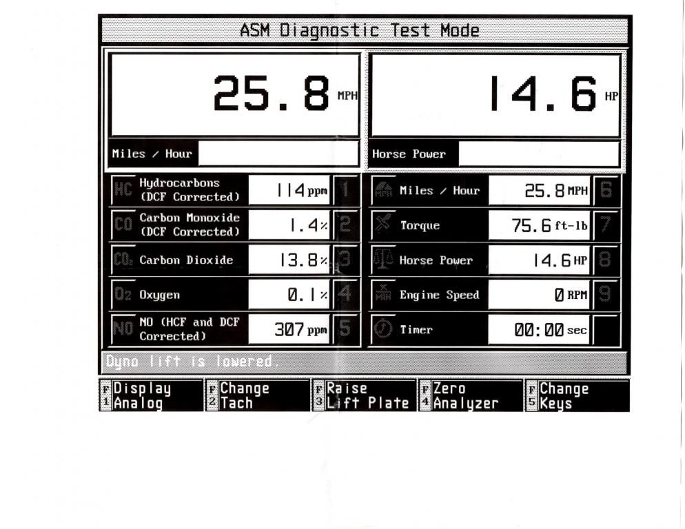

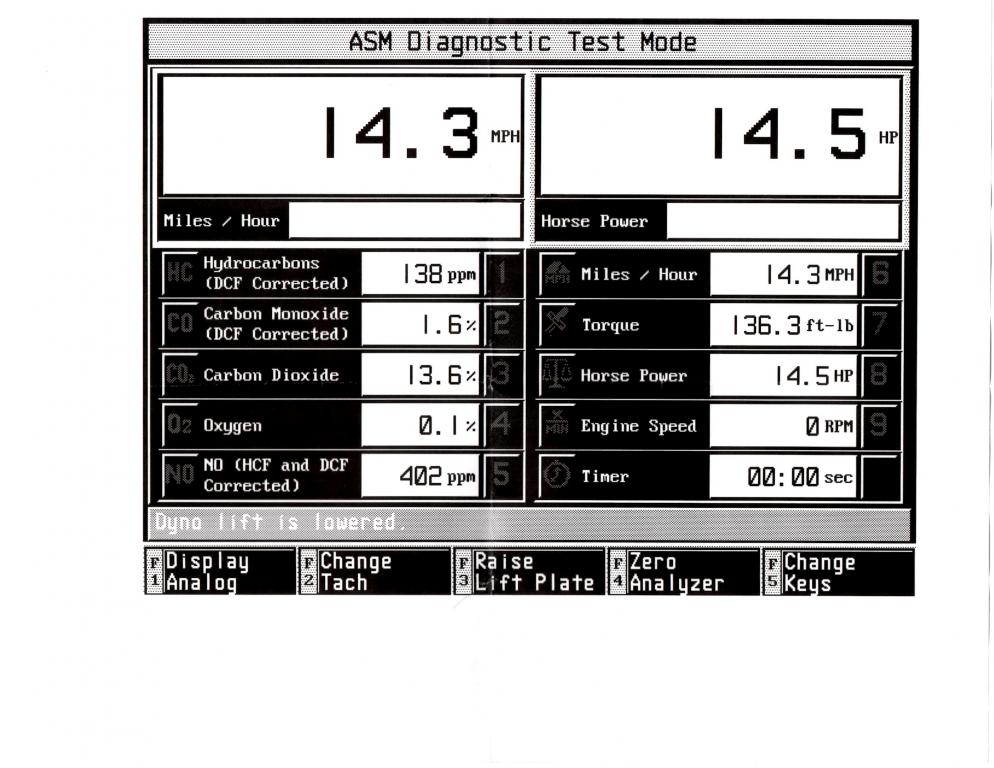

    Can't pass CA smog D:
    I took my car to get smogged about a week ago and went in feeling pretty confident until the technician told me it had failed pretty bad. He went on to telling me it's going to need an engine rebuild and that it also might need a catalytic converter so i left home pretty sad and kept thinking if it's going to need a rebuild i might as well retire it. I ended up at least trying to get it to pass so tried a couple simple things like the 02 sensor, spark plugs (NGK ZGR5A's instead of the Bosch platinum +4's it had), coil, different air flow meter. Since they were giving me a diagnosis for free i was like ehh i'll try and see what happens and these are the results, still failed i might add. Where should i go from here?
