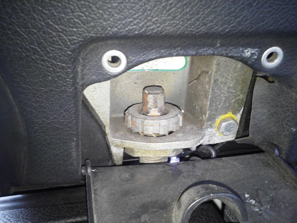

    Remving hard top
    How do I get this off?
    I was expecting a nut?
  • DRTSRFR
    • May 2008
    • 1836
    I've never seen anything like that...
    It should look like this...
    Suspension tips here...
      is that like a threaded nut you unscrew then just lift top off?
      • DRTSRFR
        • May 2008
        • 1836
        You don't have to "unscrew" it. it rotates about 3/4 of a turn and unlocks the pin.
        Does your assembly look like it's screwed in in any way?
        Is the top actually locked down back there? Or did somebody put some sort of pin in there that doesn't lock?
        I don't know everything about these tops other than what I have to draw from on mine.
        http://www.r3vlimited.com/board/album.php?albumid=757
        • Todd Black 88
          • Oct 2007
          • 3449
          That nut you see just sets the pin height. You just set that once. The top of the pin turns and locks into the recepticle on the car body.
          What you have...........I have no clue.

            i tried prying up on the bolt above the washer but its not moving? I hope noone threaded it in somehow w no way to unscrew the bolt
            • bastianshaw
              • Jan 2007
              • 2210
              damn just checked realoem looks like that assembly is #2 and $125!?
              • bastianshaw
                • Jan 2007
                • 2210
                So it's not rotating off. Any ideas guys!
                • reelizmpro
                  • 9558
                  Cut it or shave down flat spots until you can get a wrench on it. Perhaps there are flat spots already on it? Must have been some way to torque it down. Try taking off that flap without breaking it and see if you can remove it without breaking anything.

                    90 degrees or 1/4 turn releases the post. It was originally a double nut @ 11mm size on the narrow top post. BMW sells a tool for the larger, lower adjustment nut.
                    I'm also in Walnut Creek, with a hardtop on our 87. You need to see anything or want to see our top go on & off, let me know.
                      that would be pretty helpfull actually pm sent

                        I pulled my hardtop off today and for the life of me I don't know what you havegoing on there. I'm thinking you can remove the speaker panels with the hardtop on then perhaps you can unbolt the body side of the pin socket and better deal with this once its off the car.

                          what you have looks bojanged
