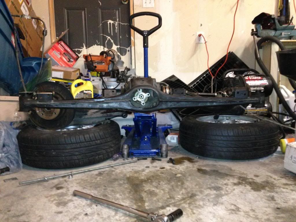

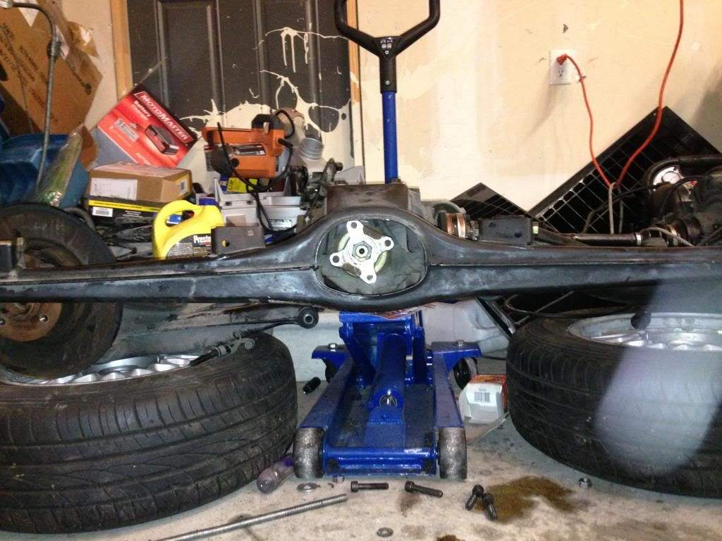

    Putting my rear subframe back together I notice the diff flange sits to the left and up in the subframe tunnel, is this normal?

    yes that is normal.

      It's so the u-joints have a slight angle in them. If they were completely straight they would wear in only one spot and would go bad real fast.

        funny- I thought it was because the pinion was on one side of the ring gear...

            This. I was taught in my apprenticeship that ujoints are designed to work at small angles, a zero offset setup will destroy them fast so it's either create the misalignment through design or run a different driveshaft. The ujoints in an offset setup will still allow for variance in assembly unlike a more rigid coupling.
