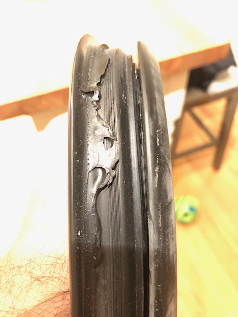

    I am looking for the material that seals the windshield flange to the windshield
    gasket. It is a black sticky substance covered with plastic. I do not see it listed on RealOEM. Please let me know where to purchase and what it is called. Thanks!

    AFAIK there is no sealant. Could be wrong, but I've never seen it before.
    looks like somebody tried to fix a leaky window.

      I have 4 E30s and all of them have this on the lower part of the front windshield flange. I am starting to re-assemble one that was stripped and color changed. This is tough to get off but the plastic keeps it from sticking to the gasket.

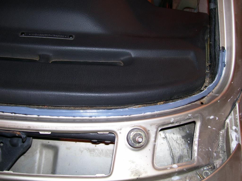

                      When we stripped Klaus for paint, there was that same butyl tape across the whole lower edge, just like in the pic.

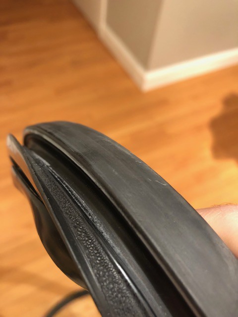

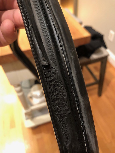

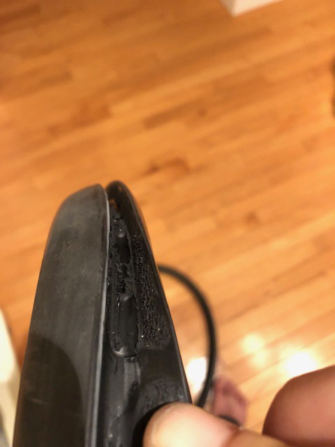

                          I have the same butyl crap on my original windshield. Also it looks like my gasket was urethaned to the top portion of the frame on the car AND some adhesive was used all around to set the glass. Butyl tape on the bottom makes sense, I have zero rust on my pinch welds etc.
                          What do you guys thing about the other urethane crap. I was under the impression its not needed for this type of gasket. Is my old gasket still reusable? I ordered new gasket to be on the safe side. Do I need to install it with some glue crap as OEM did? I'm pretty sure this was OEM fix. Could it be that BMW leak tested the car and as a result these are their fixes?
                          first two pics are the gasket lips that go toward the body, other two are the side against the glass
