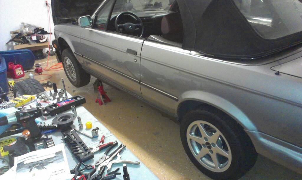

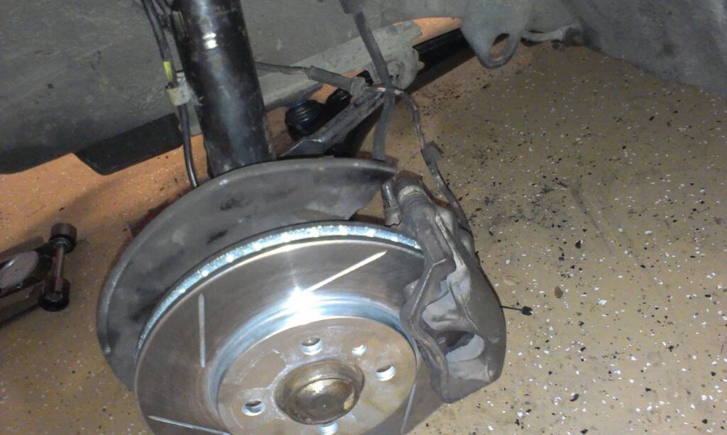

    I got it off, now waiting on strut mounts and trying to remove drivers side control arm and passenger side tie Rod
