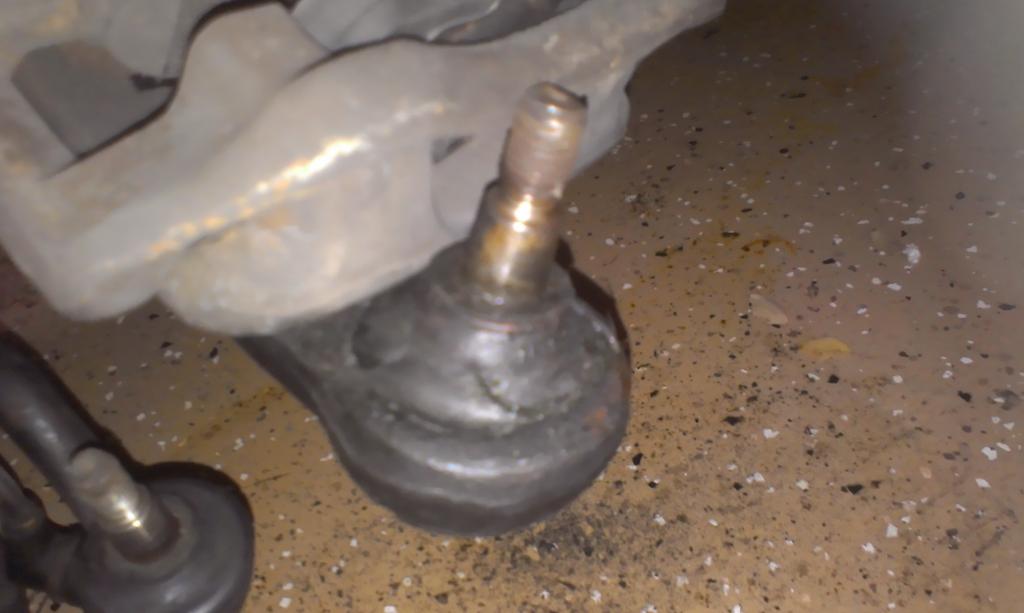

                      I have figured out the problem after heating and then using jack to try and move the arm up. The bolt from the control arm balljoint is rotating with the nut. Damn, had never noticed it before until now. I tried jacking up the control arm but that didn't work. ideas?

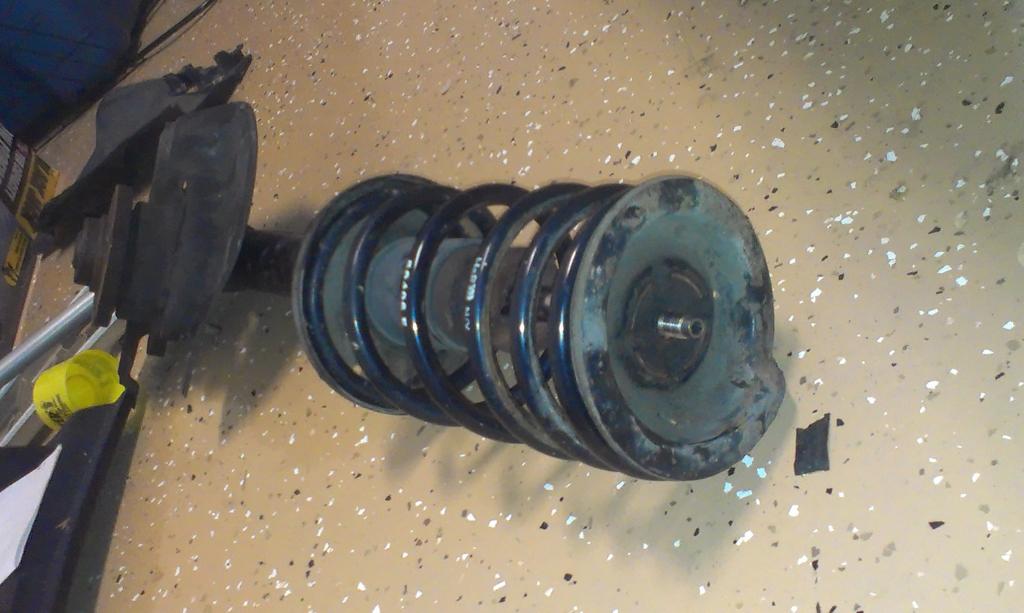

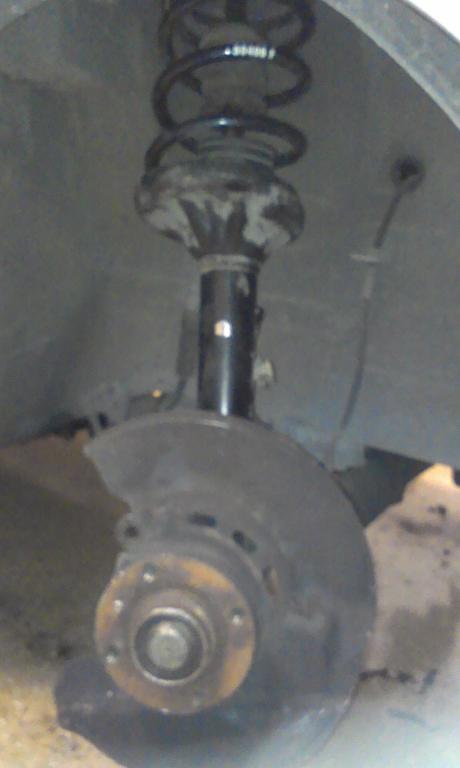

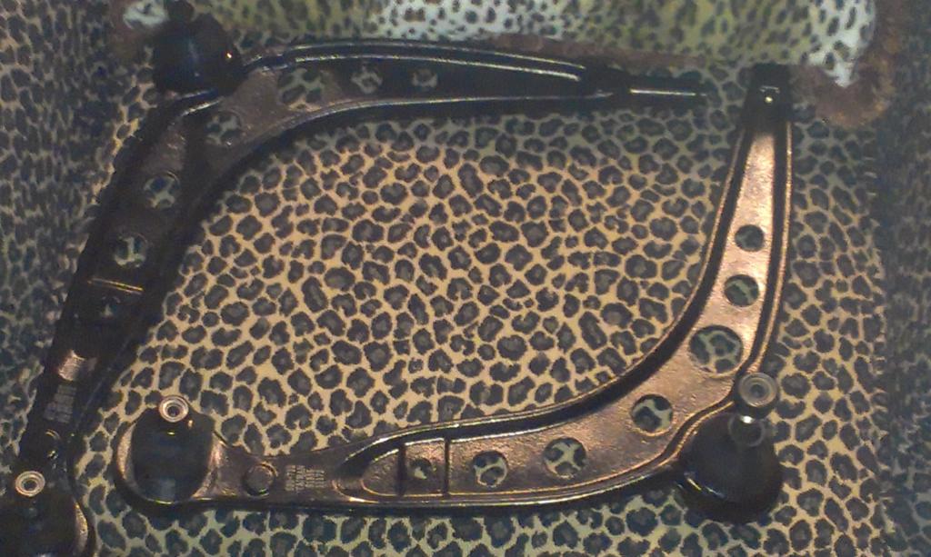

                            Here's a Pics Update (Replacing Control arms, tie rods and Sway Links):

                              if its still spring try and jack it up higher. you need that balljoint at the control arm to be seated very well for a rusty nut to spin off. also i suggest you get a long handled half inch rachet for the future. that will be a big help!

                                Soak it in PB blaster then go to the hardware store and buy a torch... They're like $15. Heat that nut up and use a jack underneath the ball joint.
