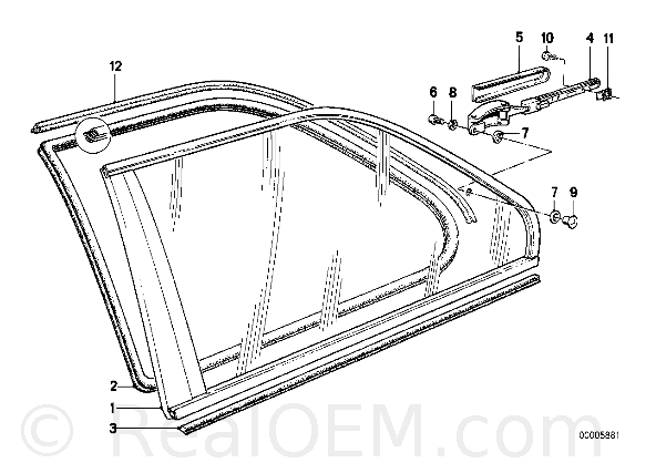

                      • michael325e
                        • Aug 2013
                        • 10
                        OK,
                        I think it would be parts labeled 12 and 3, which I believe are the pieces shown in this picture,
                        Michael

                            Originally posted by michael325e
                            Thanks for the link, and any additional info you post.
                            Mine has a piece on the bottom that looks to have the profile of the right side pieces in the picture from the link you provided. I'm not seeing anything that has that sort of modified diamond profile of the left side pieces. The one that I have that goes on the bottom is in two pieces on both sides, slides into the window trim it seems and is more like rubber than foam. So I'm still confused. Also, do I see those gaskets as having sticky tape on them so they just stick onto the window?
                            Michael
                            The foam pieces in the pic don't have any sticky tape. I never installed the smaller foam seal shown, as it baffled me how it was used. The larger seal shown, you will need to order 4 of them, as they are only half as long as the bottom of the window.
