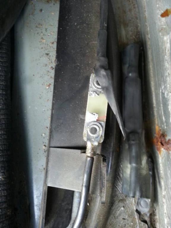

          Nailed it. Fusible link blown to hell. I soldered in a 18 gauge wire then went to radioshack for a fuse holder. It's a 50A fuse.
          The crazy thing is that 30 minutes after it didn't start, I went to the trunk to check it, but as I was pulling up the carpet I told myself the interior has power and it cranks, so it can't be that! Stupidity on my part.
          Thanks for the help.Click image for larger version
