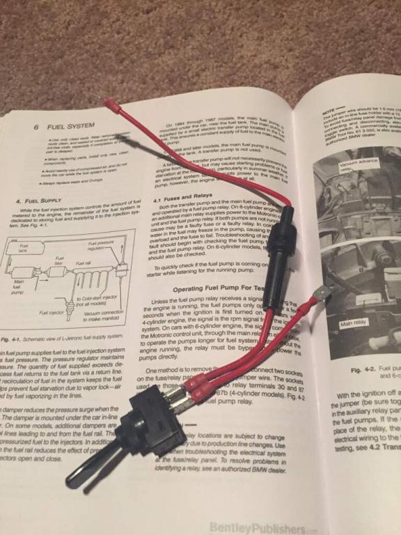

                      I actually had some time to think it over and go through some trouble shooting. im narrowing it down to the fuel portion. i dont hear my fuel pump priming at all when i switch the car on. so im going to make me a jumper with a inline fuse and toggle switch. bought all the parts today and ill put it all together and jumper the fuel pump relay and see goes on then.

                        The only time the FP is getting power is when the CPS tells the relay to close. Jumpering the relay should work as an instead of the CPS. If it works then, replace your CPS

                          The jumper cable built and ready to use.

                              well guys, just jumped 37 and 80. dead silent.
                              i think its safe to say its my fuel pump. but i will go a step further and check the lines going to the relays to make sure the electric side is good aswell.

                                Do you mean 87 and 30? Did you check for voltage at those pins? Also beware, I had this almost identical problem and replaced the fuel pump and it did not fix the problem. Granted, my issue seemed to move throughout the car, but it's just a fair warning.
