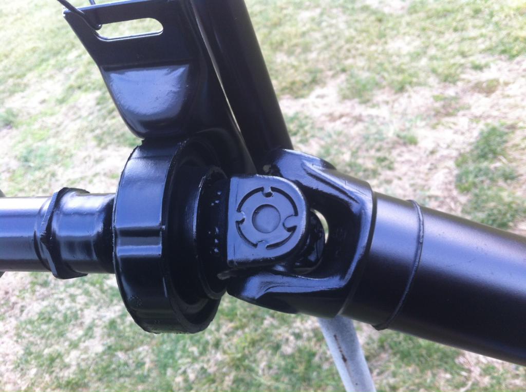

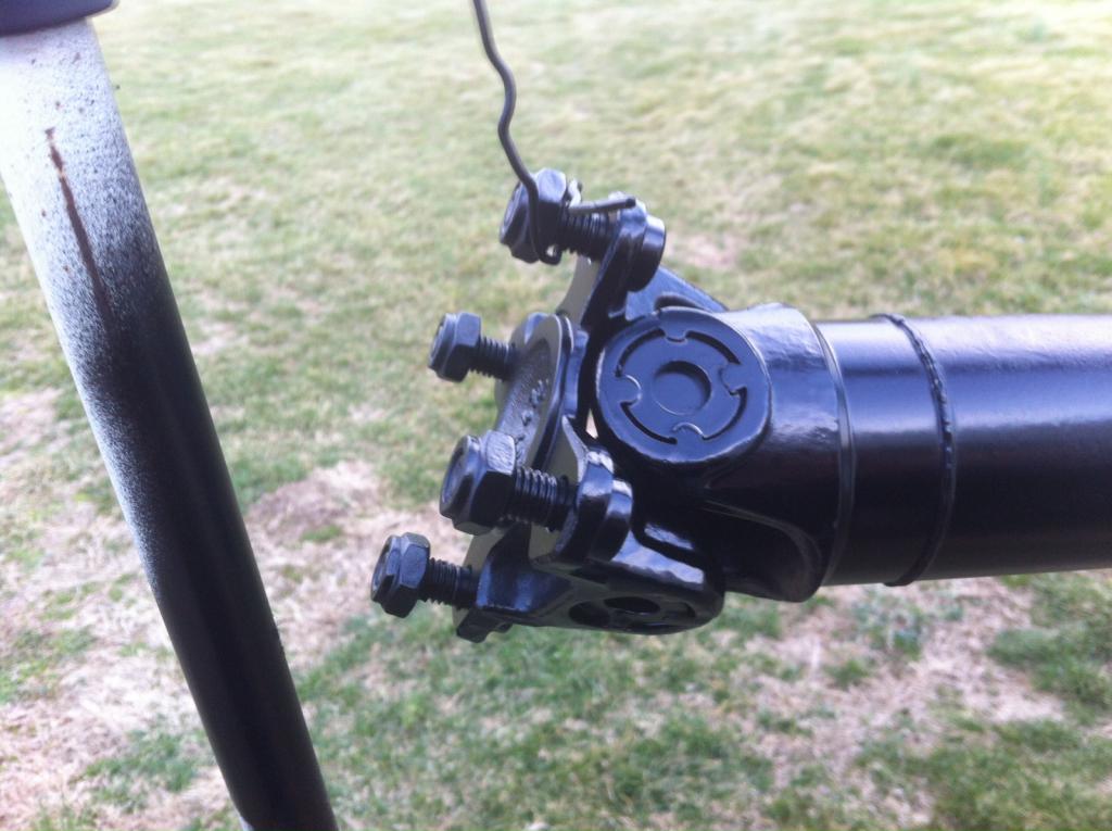

    So I had to replace my driveshaft and instead of buying a new one I had my dad and his friend (who repairs drive shafts) cut out the old U-joints and weld new ones in. Everything went back together just as it came out. That being said. I don;t think the drive shaft is my problem. After everything went back together we took it for a drive and the exhaust is leaking, I assume at the headers where we disconnected it AAAANNDD there is a stupid amount of vibration once I get up to speed. We also rotated the wheels because the front tires are a little worn on the inside. So my questions are. How do assess and fix my exhaust leak? And more importantly, what is causing the vibration? What should I check for? Thanks in advance guys

    Pic of the weld? My guess is that things did not get welded perfectly.

        These are the welds.

              Those aren't welds. Or rather, those are fusion welds...
              Oh, wait, WTF- they tack- welded the bearing caps in.
              That's a new one on me. Seems like it could distort the races that are the inside
              surfaces of the caps...
              Yeah, I'd say start with a driveshaft rebalance, and see if the balancing shop finds
              any problems with the spider and cap replacement...
