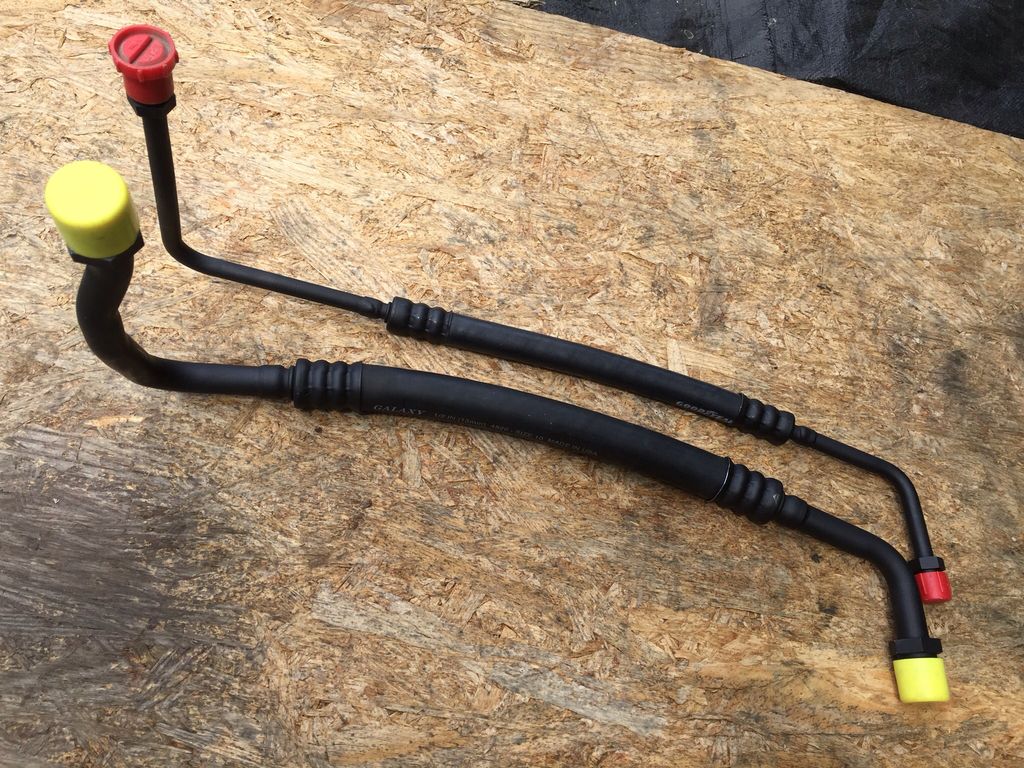

              I had a few conversations with AC shops about hose upgrades. One shop, who specialized in classic cars said they could find sweat on fittings to go with the metric tube sizes. Having done enough plumbing I figured you can braze or solder with a mediocre fit but they didn't want to do it.
              Shop I found had a machine that allowed them to compress the pipe after cutting off the old ferrule/fitting so it was a perfect fit for the sweat on ferrules they had in stock. This was what they sent back.
