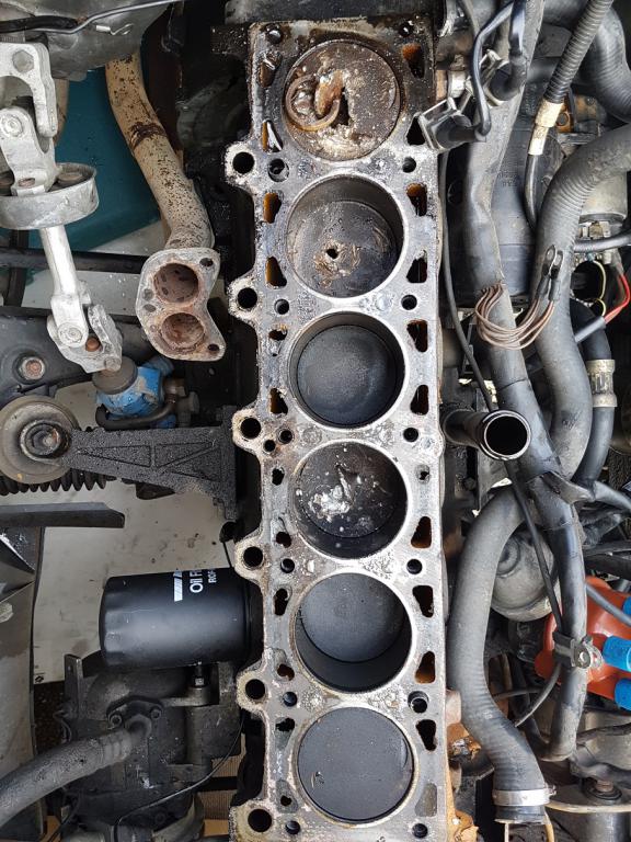

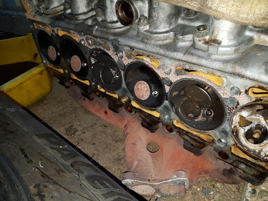

              Who knows, but this is what happens if you snap one. Worst noise I have ever heard, Engine goes in the bin. I've no idea how long it lasted, happened a day after I got it on the road. I figured i'd change it soon after registering it. Apparently soon wasn't soon enough.

                ^ouch I was lucky and mine went at near idle and the bottom end was fine. That is worst case right there.

                  yah that was around 3000-4000 rpm.
                  It really did come to a grinding hault. The noise still haunts me! Probably a blessing in disquise. That engine was stuffed.
                  Judging by the condition of the belt the last time it was changed was probably....never.
