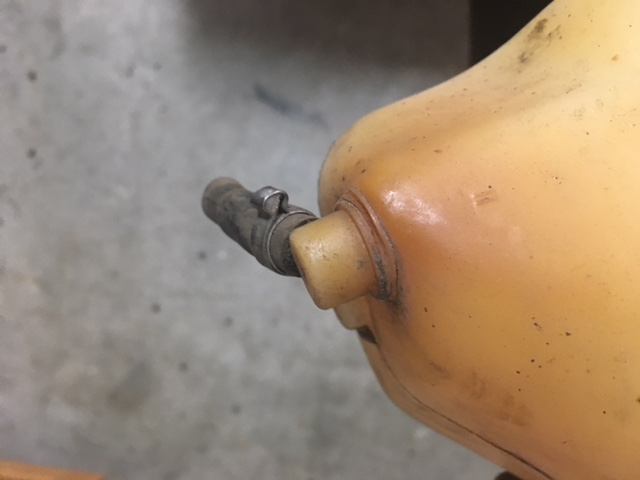

    What is the secret to removing the crimp style hose clamps that come on the fuel lines? I'm working in the overflow tank area by the fuel filler neck so the dremel is out of the question.
    I used some brute force and ignorance on a few of them but I'm afraid I'll break the plastic tank or the pipe that is fixed to the filler neck.

    Snip it on the hump and use a new one when you reinstall.

      Take a pair of cutters and cut sideways through the edge of the material.

        Well guys I guess I need a better pair of cutters or stronger hands. I tried three different types of hand held cutters that I have and it didn't even dent that stainless clamps.
        Now that I have the tank on the bench I play a bit more and try a few more tools. There are three more clamps up under the fender well that are a bit difficult to get to.
        I was pretty frustrated last night and stopped before I broke something.
        Thanks! And any other ideas are welcomed.

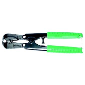

                    I have a small bolt cutter-
                    works pretty well. It cuts sideways
                    through the hump, so it won't crush
                    the fitting. Made by HIT.
