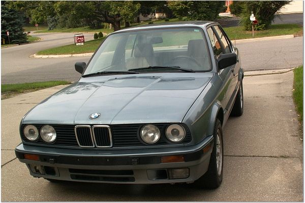

                My car was flat towed behind an RV for a few years by the previous owner. The attachement bar was welded to the front of the bumper shocks and can be seen as the two little bars sticking out of the front bumper trim in the picture. I haven't had any problems that I can directly attribute to the flat towing.
