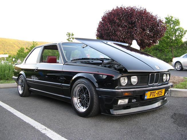

                      I used a piece of pipe that was about the size of the shock body. I cut it down to the lenth i needed the hood to stay up. For me it was about 2.5" long. I cut mine that short since i'm taking the e30 to car shows/cruises now, and i don't want the hood all the way open. But i'm sure this way would work with hood opened up all the way. I took the pipe and cut a section out of one side for it to slip over the rod on the shock. Then i position it so it rests on the part of the hood hinge where the rod of the shock attaches too, and the other end rest aginst the shock. I used it this weekend and when the wind blew, the hood stayed put.
                          That looks awesome, got any pics of the actual item?

                              Awesome, thanks a lot, that is really neat.
